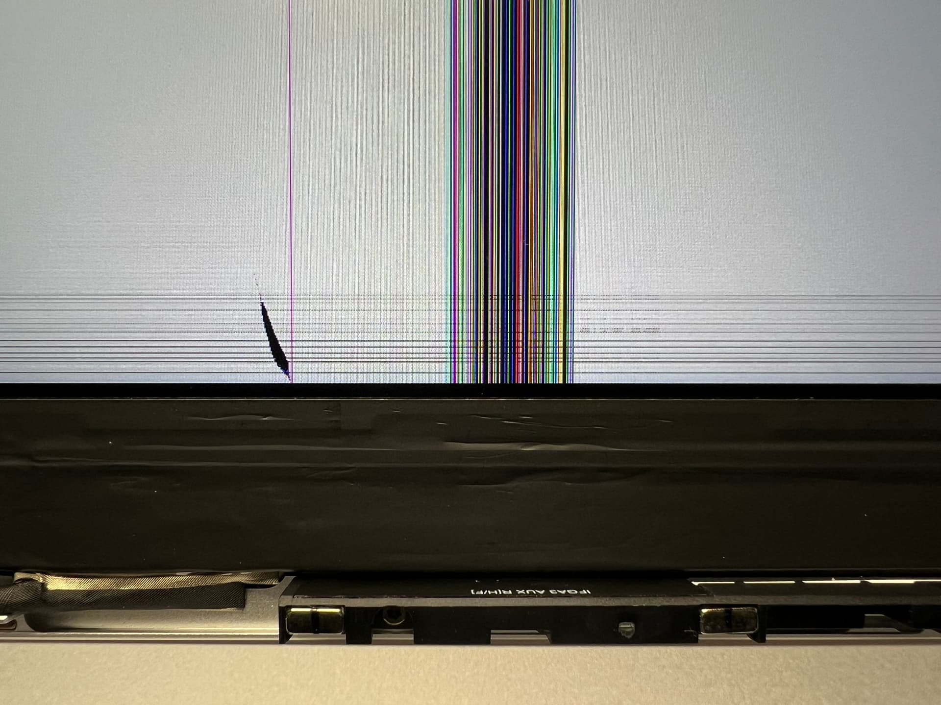

My AMD FW13 screen is malfunctioning similarly, and support has thus far refused the warranty claim, insisting it’s customer-induced damage. They highlighted this section of my screen:
Implying that the artifact indicates physical damage, but it’s 100% digital, there are no indications whatsoever of physical damage. They also chided me for lightly touching the bottom of the screen (which induces a horizontal flickering), further implying I was compounding the damage (?!!)
Reading through these other reports, I’m crossing the line from being upset about a questionable warranty refusal to suspecting a systemic defect that Framework is not acknowledging. Either their screens are of poor quality, or their hardware design readily allows internal damage during normal use that other laptops do not suffer.

Thank you for this thread. I am experiencing a similar issue with my FW 13 AMD. The support team is refusing to replace the screen, which is still under warranty, claiming it is Customer Induced Damage (CID). However, there are no visible signs of damage on the screen or the laptop. I have primarily been using it as a desktop, connected to an external screen, since purchase. The support team suggested buying a new equivalent screen for €179.00.
I am still awaiting their final response. If the replacement is refused, this will certainly be the first and last machine I purchase from this brand.
Please find the attached photos for reference.
