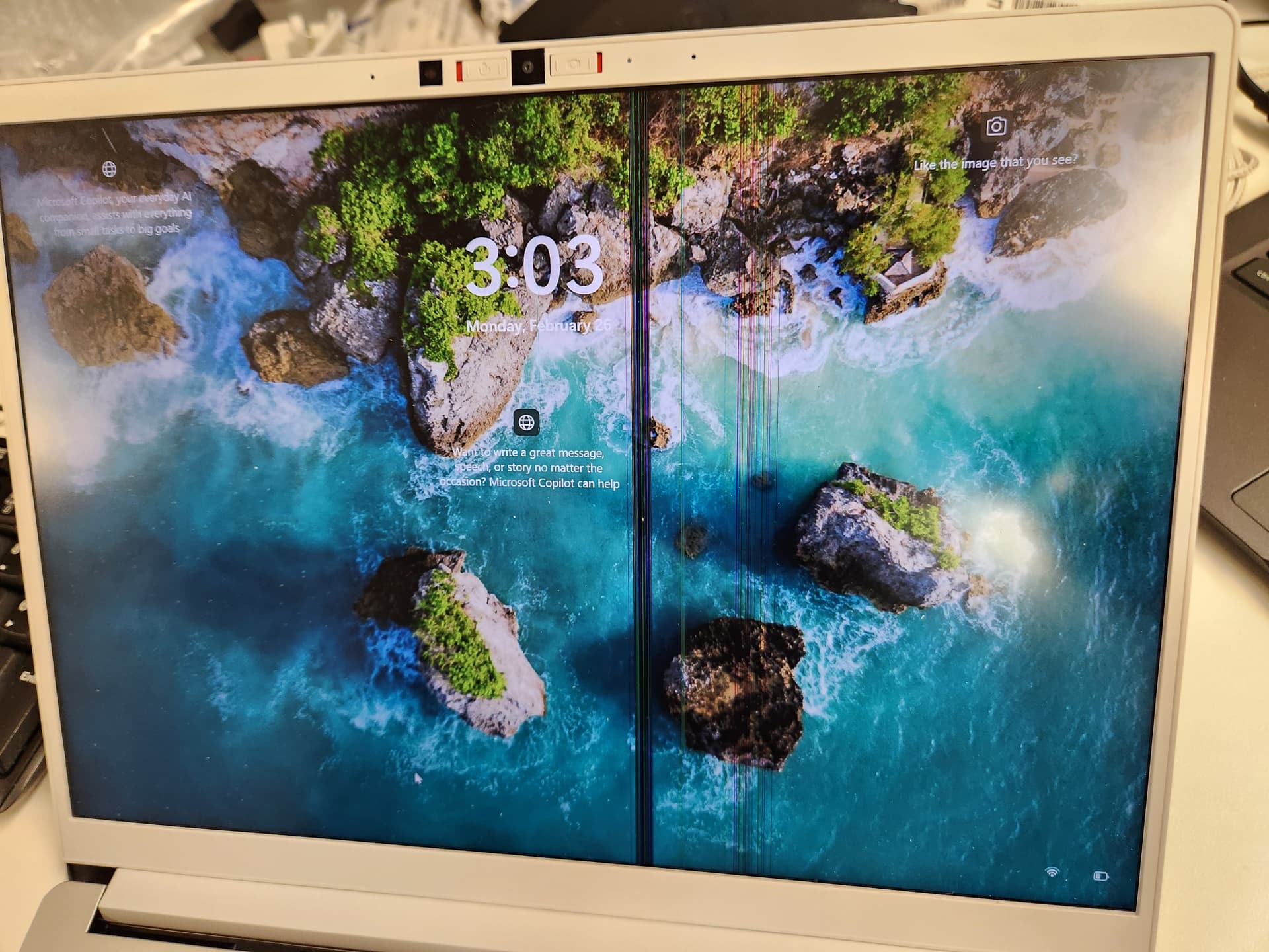

I just booted up my computer and there was a series of vertical lines of various colors going down the screen. I tried restarting a few times and they didn’t go away. It wasn’t doing this last night. I’ve attached an image of it below. Any idea of what could be causing this and how to fix it?
Do you see that during boot up or in the BIOS?
It looks like physical damage. Did you put something heavy on the lid with it closed? Has the lid been twisted?
@Fraoch it appears as soon as soon as the computer is turned on and throughout boot up. I haven’t checked, but it presumably appears in BIOS too. I’m not aware of anything heavy being on it, the screen being twisted, or any thing else that would have damaged it. I was watching a video on it last night and I set it down before bed and picked it back up this afternoon. I noticed that if you put a little pressure on the sides of the screen the lines flicker and change positions a bit. So I tried unplugging to cable to the display and plugged it back in but that didn’t change anything.
Sounds like a broken panel, and even if it isn’t, get in contact with support, they should be able to help you. Just know that support times have been a bit slow recently due to an increase in tickets, so it could take some time to get a response, but if you contact them they will get back to you as soon as they can.
Please submit a support request through Framework Support
Possible physical damage.

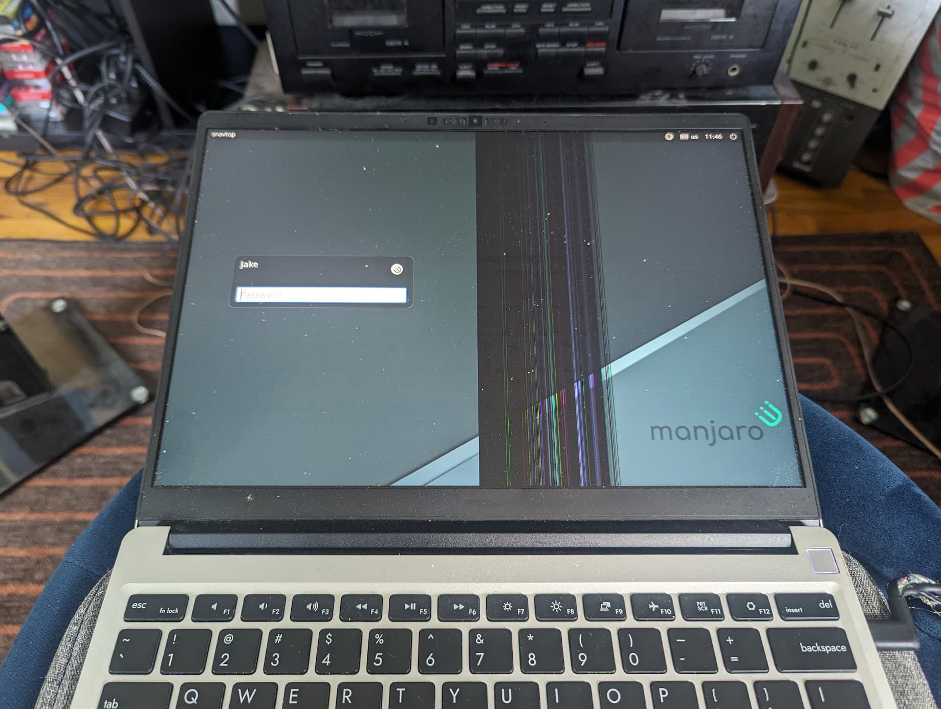

I have something similar, just one column lost, but also a splotch above it that looks like perhaps too much pressure on that point in shipping or something.
(This was the first time I’ve turned it on. I’ve already submitted a support request.)
Ah, yes, certainly in my case - ‘nicely’ aligned with the affected area:
(Sorry I’m partly just posting because I’m having trouble with email attachments, so this is convenient hosting for me to reply to support request with a link :smile:)
The one with the lines is probably a panel problem, not physical damage.
I had a TV that did this spontaniously.
if it is damage you usually see all sorts of colors and a clear crack in the screen.
At least, that is what I see when someone has dropped the laptop.
Thank you all for your responses and sorry for the very delayed response. But I just wanted to send out an update. I contacted customer support and they said what many of you did, that it sounded like a damaged screen. They said they would send me a new one free of charge. It was rather challenging getting it because since buying the computer I moved to Sweden which they don’t service yet. But we finally managed it and successfully completed the replacement. It definitely felt good to have my computer back.

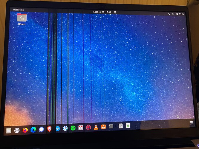

Oh Jeez. My AMD FW13 just did this, this weekend, and I already have a support ticket open, but now I’m wondering if I should just buy a panel out of pocket and save some headaches.
I have no visible signs of damage, just a ton of vertical lines about 2cm from the left side. Shows in the bios, never goes away, flashes and sparkles if I touch the area where the lines start, at the bottom of the screen.
Repairable is great, and I’ve pitched and advocated for Framework pretty hard, but probable defects like this are a heartbreaker. I have stuff I wanted to be doing on my laptop this weekend, and now I can’t. Hearing that support is likely to be difficult makes that support worth less.

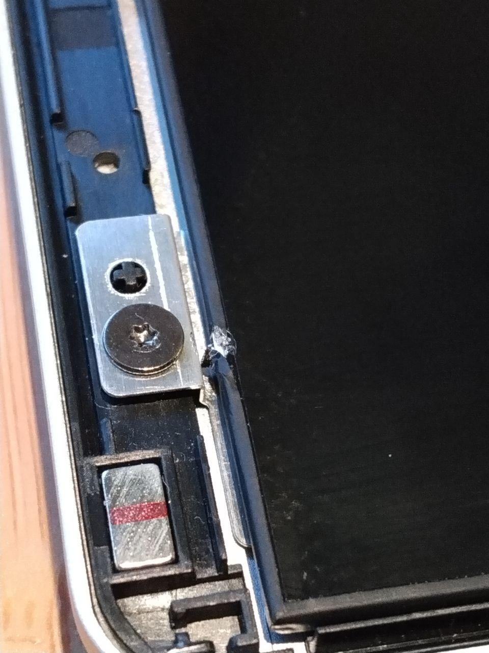

Bad news: In my case at least, it looks like an assembly error led to the screen killing itself, possibly by twisting/bending the eDP cable. Support conspicuously declined to address my questions about this.
I say “assembly error” and not “bad luck” because in my case, there are two different adhesive patches on the eDP and antenna bundle wiring bundles, that look like they are supposed to hold the cable bundles in place and keep them from twisting around the hinges. I checked my Framework Chromebook and both cable bundles are secured in place with the adhesive. On my AMD 13", both adhesive patches still had the cover/mask in place. The eDP cable had a small bit of the white heavy paper with a waxy side, and the antenna bundle cable had a small blue piece of plastic over the adhesive. I don’t work in the OEM factory, but that sure sounds like a missed assembly step to me, and while I’m not an expert, it certainly seems plausible that it led to the failure.
Anyone else with a failed screen see anything similar? We might all have gotten one-off “bad luck” issues, there are a lot of Framework machines out there, but I’m curious to know if the same errors have showed up more than once. I’ll see if I can get my photos somewhere that I can link them here.
Photo links
eDP tape backer 1
eDP tape backer 2
Munged screen
Pardon the dust and the Google Drive links. Shouldn’t require login. Shortly after I took these photos, everything that’s lines and to the left of that went dark, so apparently a few more flexes took the broken wires from “kinda dead” to “all dead”. I’ve had my AMD FW for about a month to a month and a half, so based on anecdote alone, I’d say unsecured eDP cables die rather quickly. I’ve checked my other FW, and it’ll be a day one check for anything else I buy.
Worth only what you paid for it, but I felt I owed an update. FW sent me a replacement screen, it shipped from NJ and arrived promptly, and fixed my issue. Appears to have been in the panel and not the cable, too.

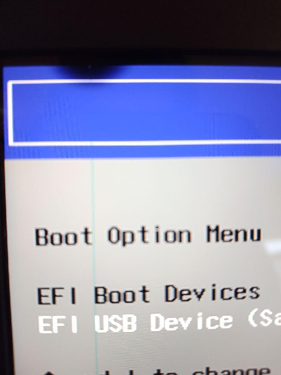

I’m having a similar issue as described above, in exactly the same place:
Put in a support request, but I assume I’m no longer under warranty, so unless they get back to me soon and agree to replace it, I might just buy a new display and replace it given the above conversation about root cause. Might be fun to see how a matte screen feels :slight_smile:
