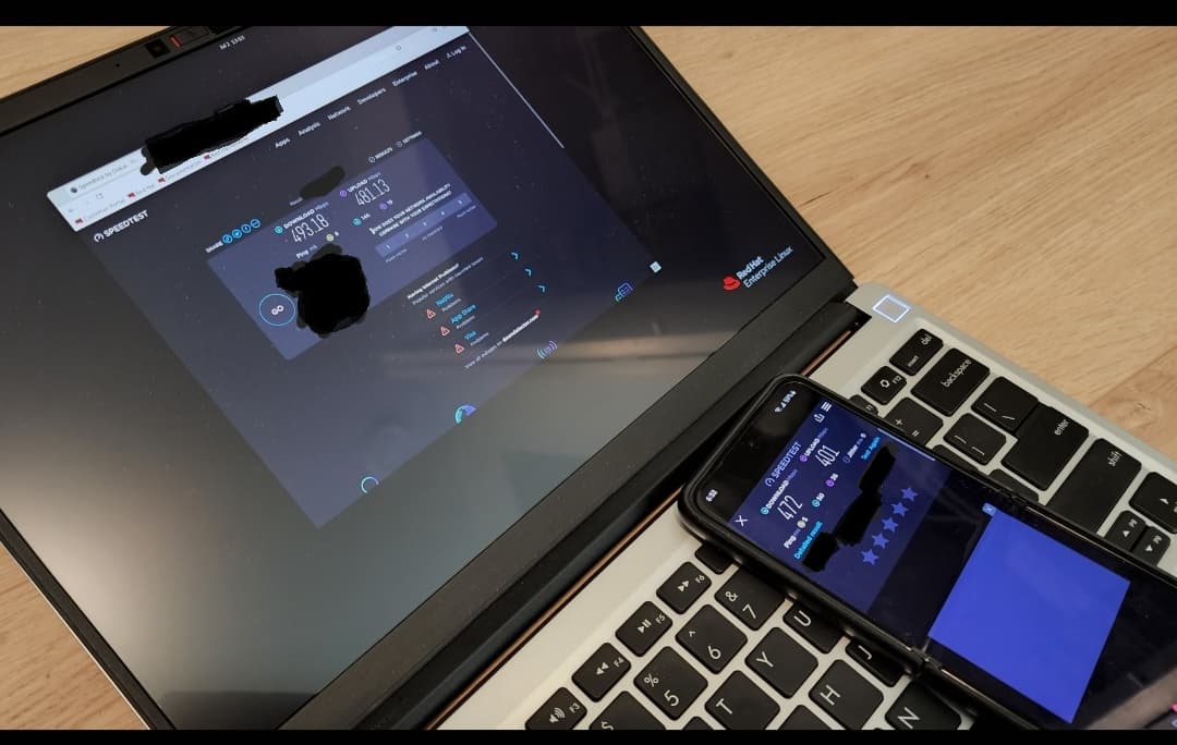

(Pictured is the Pixel 4)
Here’s mine…they’re close enough in performance. (Router: WRT3200ACM, firmware: OpenWRT)
That is 5G I presume. Could you test it on 2G?
Yeah, on 5GHz. 2.4GHz is just so congested (by other people), and microwave oven and other crap… and slow…not worth the effort to troubleshoot really.

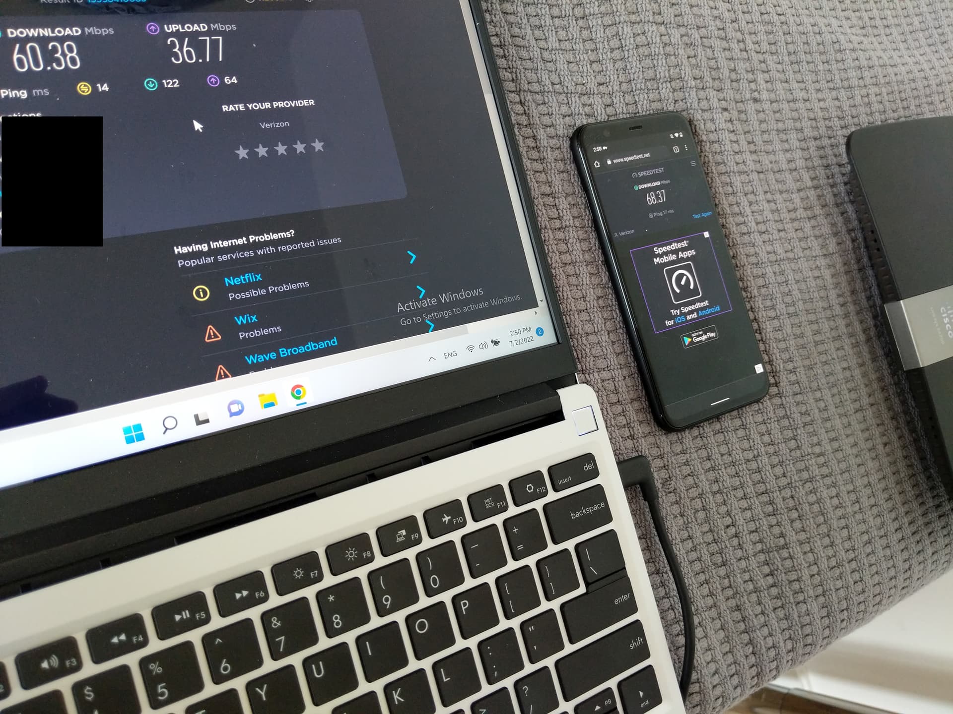

When Framework and Pixel 4 are inches away from the router:

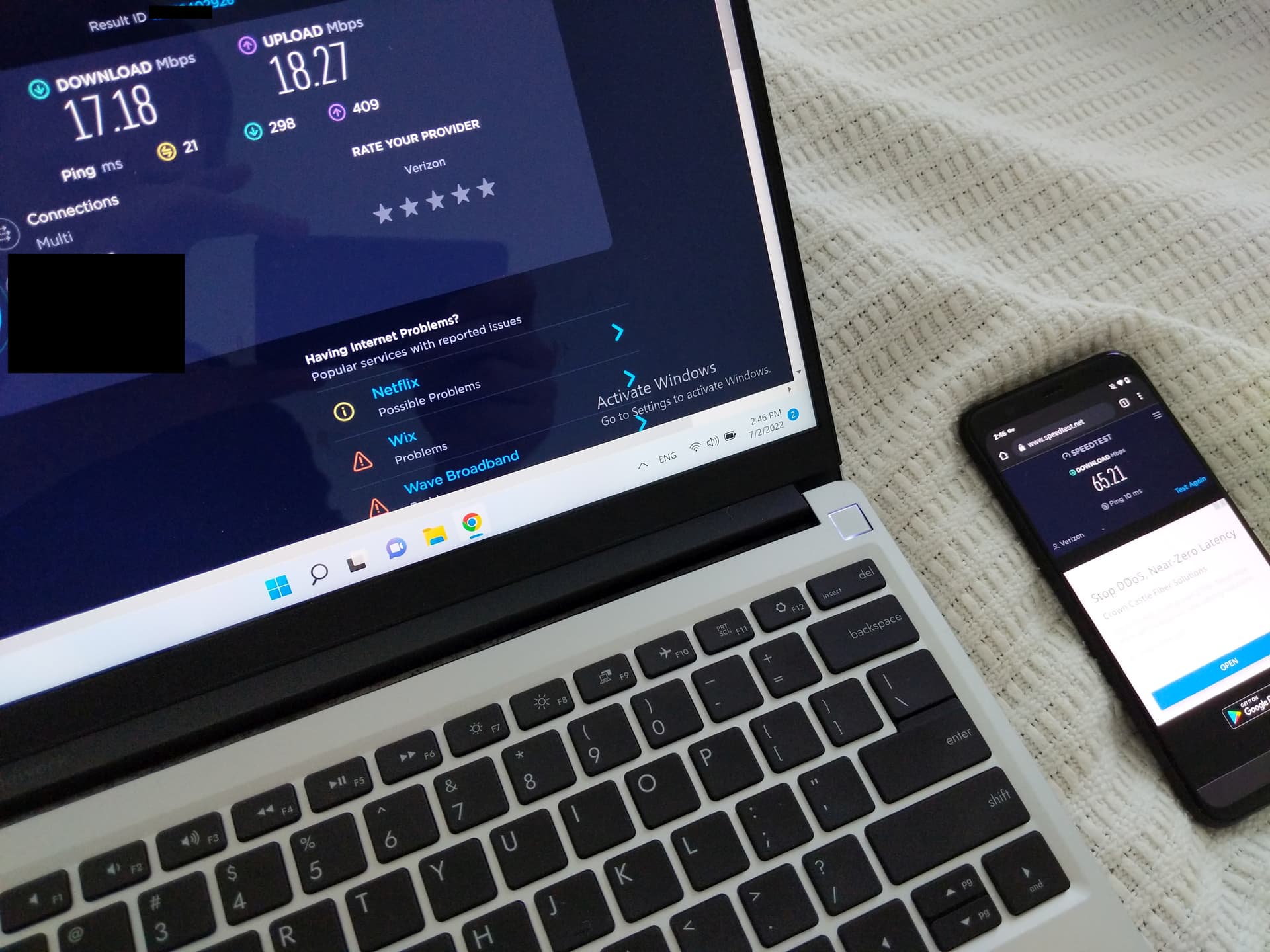

When the devices are in the next room over:
The framework drops off in speed when its even a short distance away from the router. The Pixel 4 maintains most of its speed.
Wouldn’t this alone suggest something is wrong with the framework’s reception?

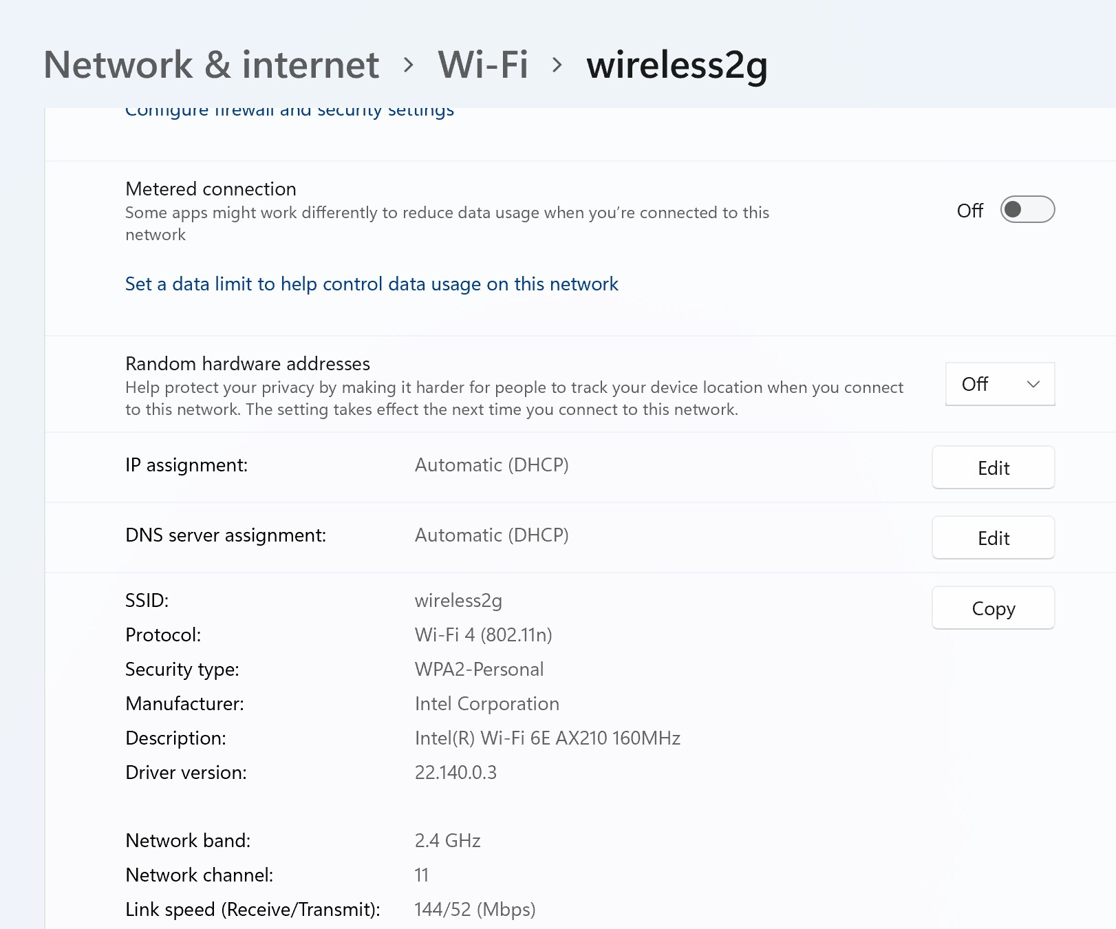

Please click on the WiFi icon and :magic_wand:reveal the LINK SPEED :magic_wand:
Internet test are not giving me any information on your local network connection or are we troubleshooting you internet?
It seems likely but you are not testing the LAN so I cannot be sure.

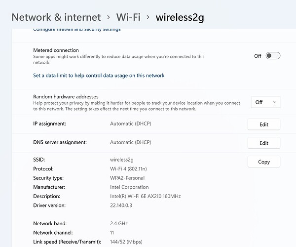

Is this what you mean?

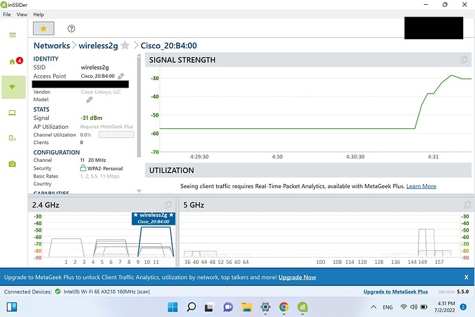

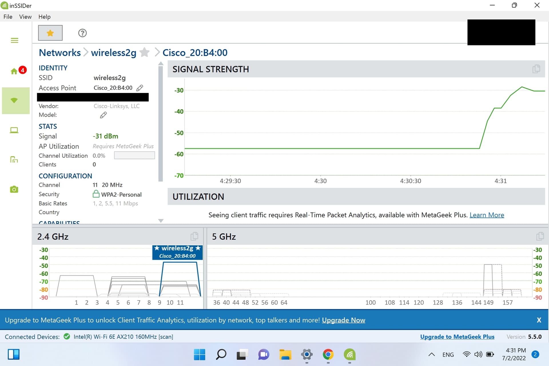

I finally have inSSIDer up and running.
The graph shows me walking the laptop from my bedroom to the living room.
Please let me know what else could be helpful. I’m learning as I go here.
Yes exactly, the link speed is a measure of the connection between your laptop and the router, the part we are interested in.
See how that speed fluctuates on the locations where performance is bad, you may need to open and close the wireless “2g” page to refresh link speed (now I know why you were calling it 2g not 2.4 GHz :smiley:) also look at your RSSI (signal strength) especially in relation to adjacent networks to see if they are causing interference.
It doesn’t explain why the FW would perform worse than your phone but at least it is more information for ideas. Did you check the WiFi cards pins/receptacle for anything that looks wrong?
That speed drop off is very significant especially considering signal (-58) to noise (-70) is still OK. -70 RSSI is your noise level when your 2.4GHz WiFi will start to be the same strength as neighbouring channel 11 signals. You can see that in the 2.4GHz box in you latest picture.
