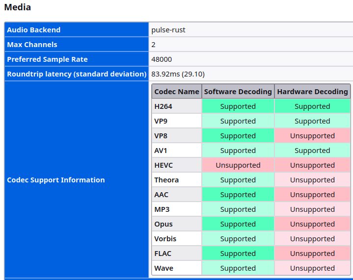

The videos are still playing fine. Are they in the list of available codecs for hardware acceleration? How do I find out?
Codec support in OpenSuse Tumbleweed is even better than in Ubuntu 22.04, where I wasn’t able to display any video stream from surveillance cameras in vlc. In OpenSuse, it just works (H.264, mainly).

I think that’s most likely the same problem I had.
I probably didn’t think it was relevant because it was for a different laptop and OS.
