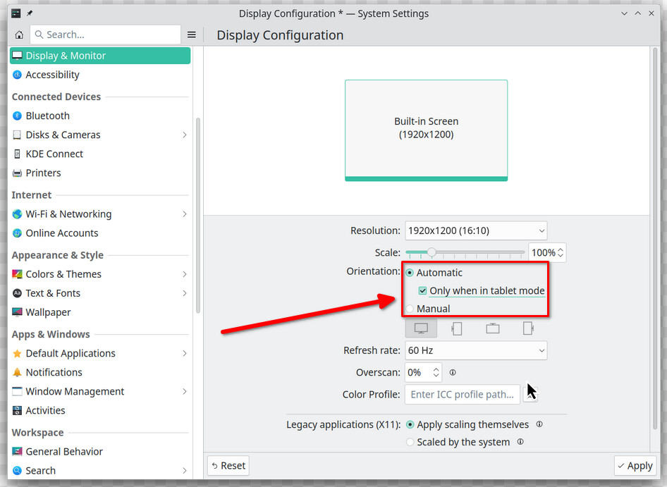

This was also sufficient to get tablet mode and automatic rotation into a working state. Strangely enough even though the correct output was shown in monitor-sensor, the option to enable automatic rotation didn’t appear in the KDE Display Settings. The section marked with the red rectangle is still missing for me and I have no idea how to make it show up:
Because of this I was under the assumption that what I was trying didn’t work and kept looking for other solutions until at a certain point I ended up demonstrating to my wife (for whom I’m actually setting this machine up) how monitor-sensor can indeed read the accelerometer values and ended up flipping the screen back, when suddenly BAM, it rotated, which meant that it can actually be enabled without showing up in the settings at all. :man_facepalming:

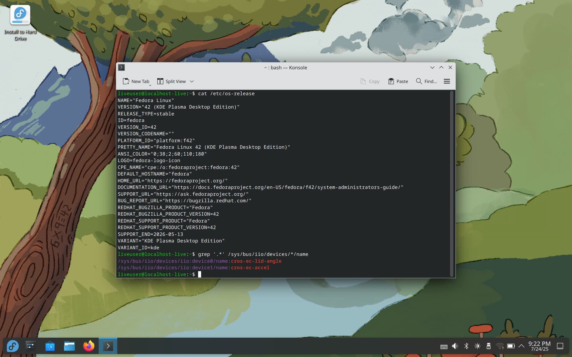

This is all I have:
$ grep '.*' /sys/bus/iio/devices/*/name
/sys/bus/iio/devices/iio:device0/name:cros-ec-lid-angle
/sys/bus/iio/devices/iio:device1/name:cros-ec-accel
/sys/bus/iio/devices/iio:device0/name:cros-ec-accel
/sys/bus/iio/devices/iio:device2/name:cros-ec-lid-angle
If you boot to a Fedora live USB do you have all 3 devices?
Now that you mention it I realize that I have also come across this thread while looking for clues around here. I’d be happy to copy my NixOS related findings over there if it gets unlocked.
Nope, always two devices.

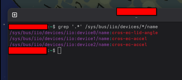

I just asked my friend to try it on his FW12, his first device is lid-angle vs my third device, I’m wondering if the sensors load or get installed in the wrong order if autorotate breaks, because mine isn’t working right now and his is:
