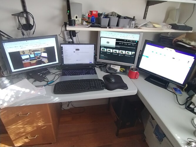

I bought a Mokin dock.
MOKiN Multi Display USB Dock - Triple 4K HDMI Monitor, 100W PD, USB 3.1/3.0 & 2.0, RJ45, SD/TF, Audio for Dell/Lenovo
$129.99
It works well, and I am using three older monitors with it. It came with a PS, and that feeds the dock, the dock feeds the monitor signals, sound, USBs and the FW16 through a short 3 ft cable rated for the power required. The cable end for the FW16 is a right angle so it does not stick out.
Using the exact same, and it works like a charm.
