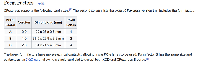

I see type A is 20mm wide, 4mm less than a full size SD. Worth exploring the size of connectors that can be found in small quantities. I took a glance on mouser but didn’t see a type A one.
