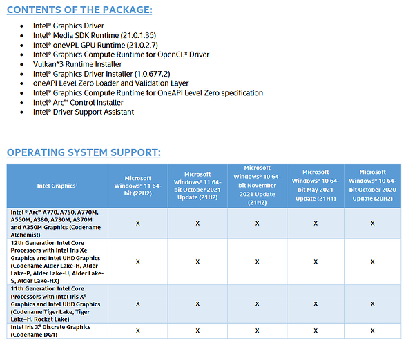

From the release note:
In short, this driver is not only for Arc.
Just note though: I’ve observed about an additional 650mW power consumption while idle with the Arc Control background processes. So I’ve disabled it from auto startup. Or just don’t install Arc Control during installation.

For the record, if you look at the release notes, yes the driver you installed is for iGPUs as well as ARC GPUs. You can safely uninstall ARC Control since it means nothing to you.
