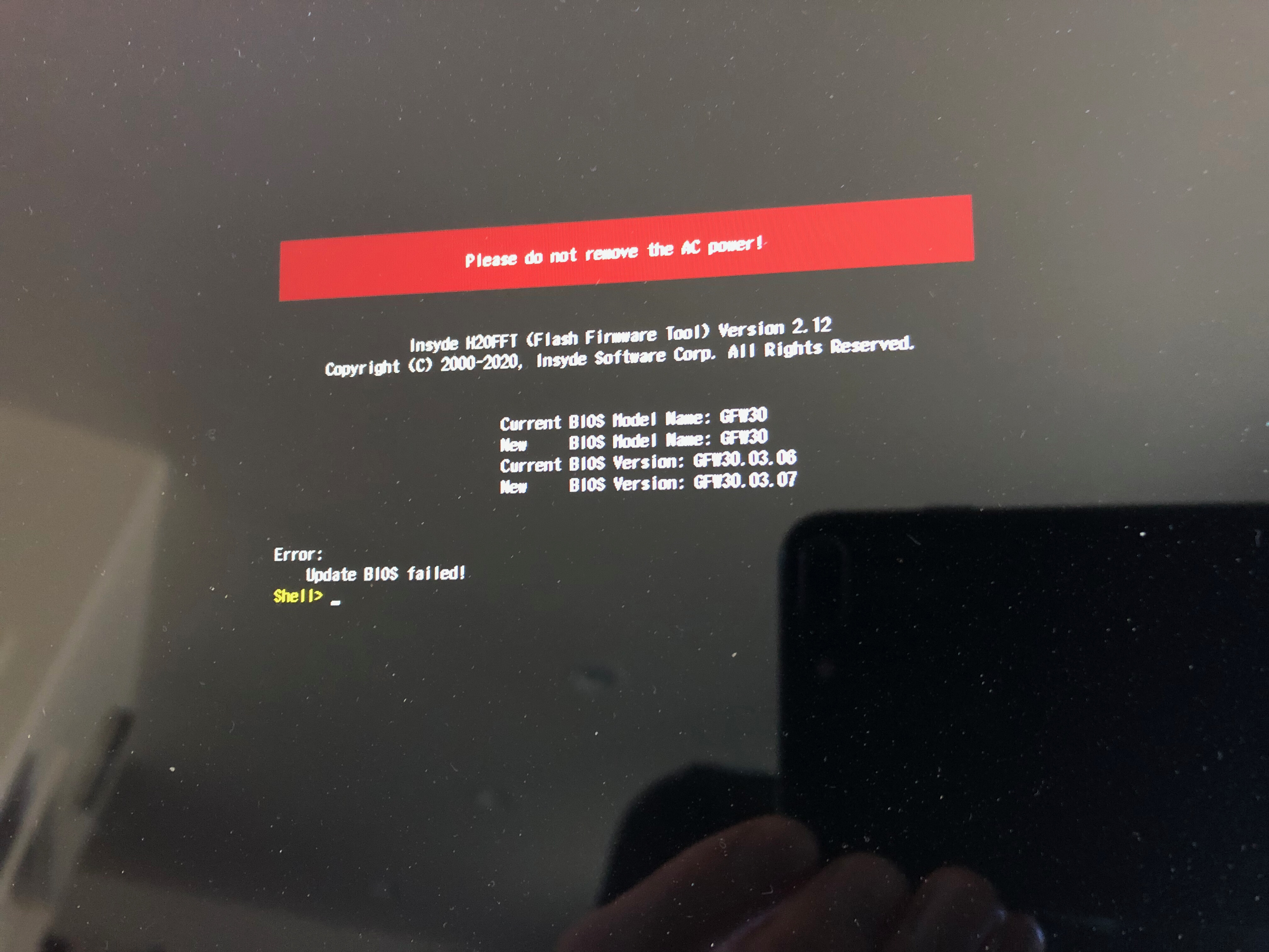

Getting an error when installing via a usb drive with EFI.
  • The drive is booting (confirmed by photo)
  • Battery is fully charged
  • AC is connected
  • Multiple usb drives tried
  • Same result on all ports
