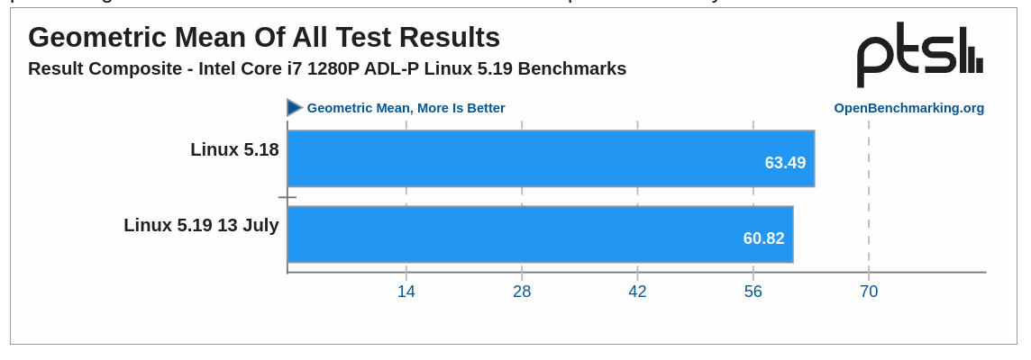

The Linux kernel has seen an improvement in batterylife for alder lake with 5.19 as well (for the cost of performance though)
For reference, these tests were made with 5.18 (iirc):
It is not a framework, but benchmarks for 12th gen are pretty scarce for now…

That s very good news, ~ 5% less speed (20% in IA) , but 20% less power drawned for the same taks. That s exactelly what I was expecting from “efficient” cores.
That s really cool, especially thinking those are crunching number benchmarks. WHere the CPU actually as very little time to get idle!
This possibly means that the battery life could be extanded more than 20% CPU wise. Looking forward to a “battery test” with this new kernel (browsing the web and videos).
Those 20% would mean we could get back the 1H battery life, we had with 11th gen, while having better performances.
