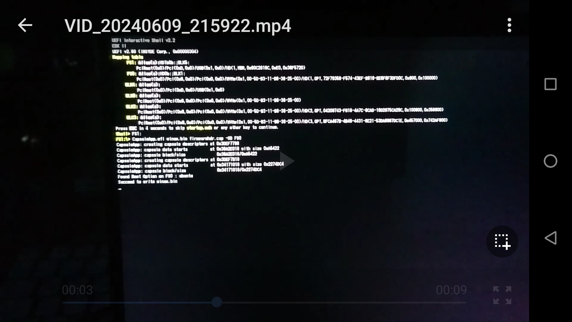

I am having what I think is the same issue. I am running Fedora 40 (single boot but formerly dual-booted with Windows 11). My main partition is LUKS encrypted, but that shouldn’t affect boot or efi, right?
I’ve tried the official way, and I have tried your suggestions, so they may influence the result. I deleted OsIndications, but it appears to have regenerated.
It’s worth noting I got the usb-PD updates by running Startup.nsh after I typed FS1:, but the firmware wouldn’t install because Framework_Tool was not found (presumable because it is on FS0, the USB drive). When I ran FS0: and then CapsuleApp.efi winux.bin firmwarehdr.cap -OD FS1, I got some messages indicating that the UpdateCapsule contents were transferred to /boot/efi, and in fact there is a new /boot/efi/EFI/UpdateCapsule folder (yes, EFI is repeated, first lowercase, then capital), and it contains firewarehdr.cap and winux.bin, but after it transferred them, without any visible error, it would just boot my computer into grub. I don’t know how to finish the firmware install.
Anways, answers to your questions:
  1. efivars (I don’t know what piping to xxd. file is)

  1. Contents of ESP partition:
/boot/efi/EFI/:
Boot  fedora  UpdateCapsule
/boot/efi/EFI/Boot:
BOOTIA32.EFI  bootx64.efi  fbia32.efi  fbx64.efi
/boot/efi/EFI/fedora:
BOOTIA32.CSV  gcdx64.efi       grubia32.efi  mmx64.efi     shimx64.efi
BOOTX64.CSV   grub.cfg         grubx64.efi   shim.efi
gcdia32.efi   grubenv.rpmsave  mmia32.efi    shimia32.efi
/boot/efi/EFI/UpdateCapsule:
firmwarehdr.cap  winux.bin
  1. There is NOT a folder on the usb drive /EFI/CapsuleUpdate/
Something strange happened here. These files should not be coped with these names to this folder.
The CapsuleApp will copy these, and name them to UpdateCapsule000x, so was this a manual attempt? Can you try to remove these two files and try again?
I deleted them (along with the OsIndications efivar) and tried again. Same as before. When the computer rebooted, I was still on 3.04, and the firmwarehdr.cap and winux.bin files were recreated. Linking a video to show what happened. Like before, there were no error messages. Just a near-instantaneous reboot.
Could the issue be some sort of interruption? Is it possible they have been copied over, but not yet renamed when it reboots? For your information, I pressed no other buttons. I would think if it had to stop because of an error or lack of space, it would show a panic message before the reboot, but while it goes by quickly, I don’t think I see an error message.

I tried to execute the command manually but no success. The laptop restarts and boot directly into Ubuntu
I send you my efivars via pm

I try 1 and 2 but no but no success. The laptop always restarts and boots directly into Ubuntu
Could you try going to the F2 bios setup menu, and go to save and exit, apply optimal defaults, and then try again? This should reset all BIOS settings to default. There may be some strange state held that this could reset and allow your update to work correctly.
I did this before I recorded the video and reported my results.
Is secure boot enabled???
Did the update including retimers. I’m not sure how to check retimer version, but bios version did update correctly. When updating the bios, I originally had my laptop unplugged but at 100% battery. It updated the firmware fine, but then when it went to update BIOS, it would give me the Framework bootup splash screen with a message akin to “Applying system upgrades” (I don’t remember the exact words) and immediately turn off.

I am in the same boat (more or less) and also tried these various ideas (setting to optimal defaults, removing OsIndicators). Interestingly, when OsIndicators exists I get the issue from @Adonnen’s picture of:
Get Boot Next Data Fail. Status = Not Found
CapsuleApp: cannot find a valid file system on boot devices. Status = Not Found
CapsuleApp: failed to update capsule - Not Found
But, after deleting OsIndicators, I do not get that error. However I get what everyone else has been reporting:
Found EFI system partition on Boot0001: EFI Hard Drive (<some stuff I am omitting>)
Succeed to write winux.bin
Succeed to write firmwarehdr.cap
But then it just boots into my OS, no updates or anything! And then OsIndicator exists again.
My BIOS is currently 3.04, I have a batch 2 12th gen.
(P.S. I hope I didn’t mistype anything in the code snippets above, I am trying to transcribe from a blurry video I took of the process haha)
EDIT: I should note that for me it so happens that FS0 is my NVMe drive and FS1 is my USB stick.
Been trying everything mentioned here for the last few hours. I’m on 3.04 as well as nothing I do has worked. The best I’ve gotten is a few quick reboots and then back into fedora. I get the same two files in the EFI CapsuleUpdate folder, even after I force the updater script to use the nvme drive as FS0 or FS1 depending on the partitions on my USB drive. I tried plugged into power and unplugged, I tried deleting the osIndicator files. I tried letting the script run and trying it manually. Nothing except reboots back into fedora and dmsicode still says 3.04. One of my retimers is 310 and the other is 2**.
At this point, I’ll just wait for the official release for Linux. The other option would be to buy another nvme drive and install windows just to do the update and the swap drives back. I should add, my laptop works just fine, I was hoping the bios update would have some low-level performance and security and power utilization updates. Looking forward to seeing it and would rather not brick my laptop.
