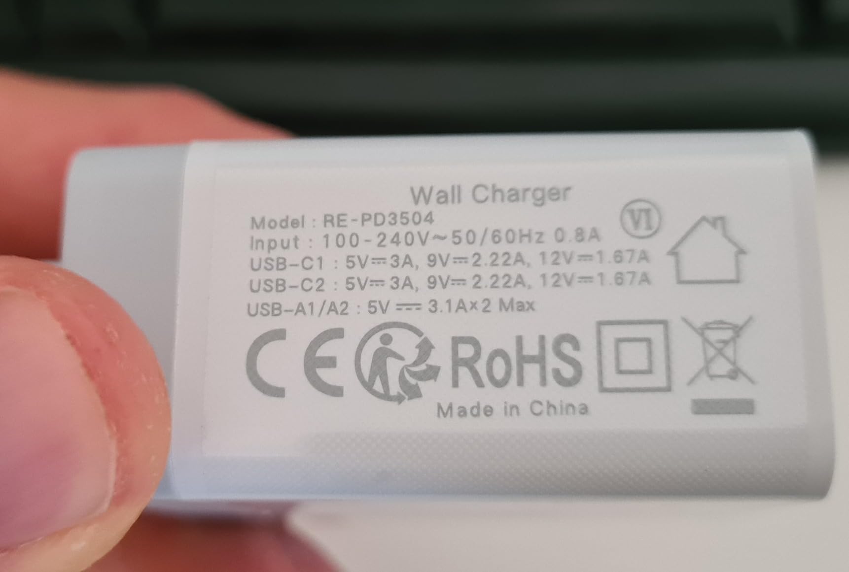

From reading the charger’s specs, it says it will not provide 40W if one cable is used. Each USB-C port is 20W max. There are customer pictures of the label on the side of the charger which also says that.

Odd. The label on the charger does say 20W max per port.

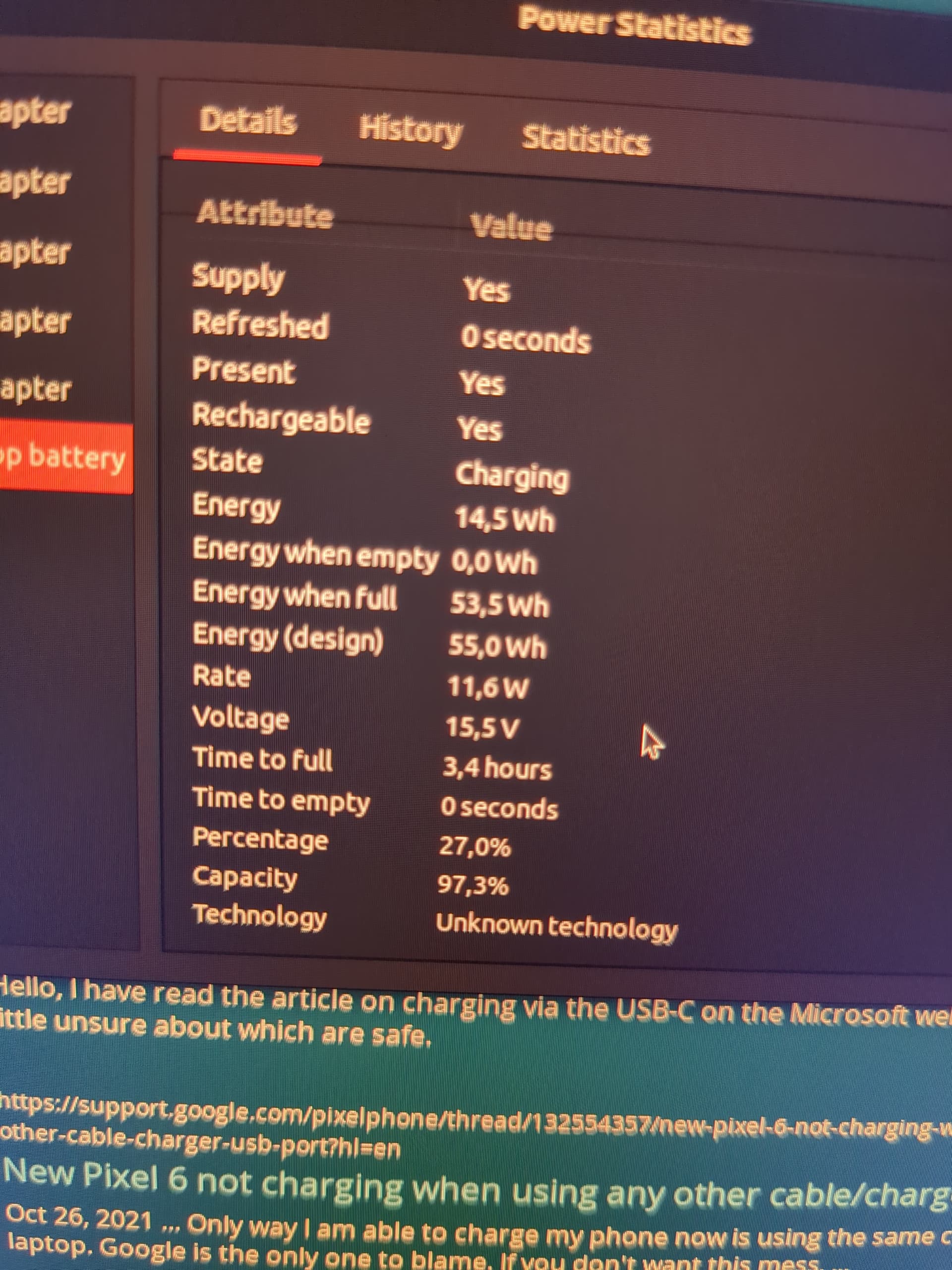

I just downloaded that, but now that it seems fine on my framework - I actually checked the power app on ubuntu and it says it is charging with 10watts/15V?!

Can you check the label on the side for it’s specs. Others posted pictures showing it doesn’t even do 15v. Either the ubuntu power app is wrong, your model power adapter is different then what others have shown, or the adapter doesn’t even follow its own label.
Or ubuntu is just showing the current battery voltage. That’s more likely. FW13 uses a 4 cell in series battery, 15.5v is within it’s range.
