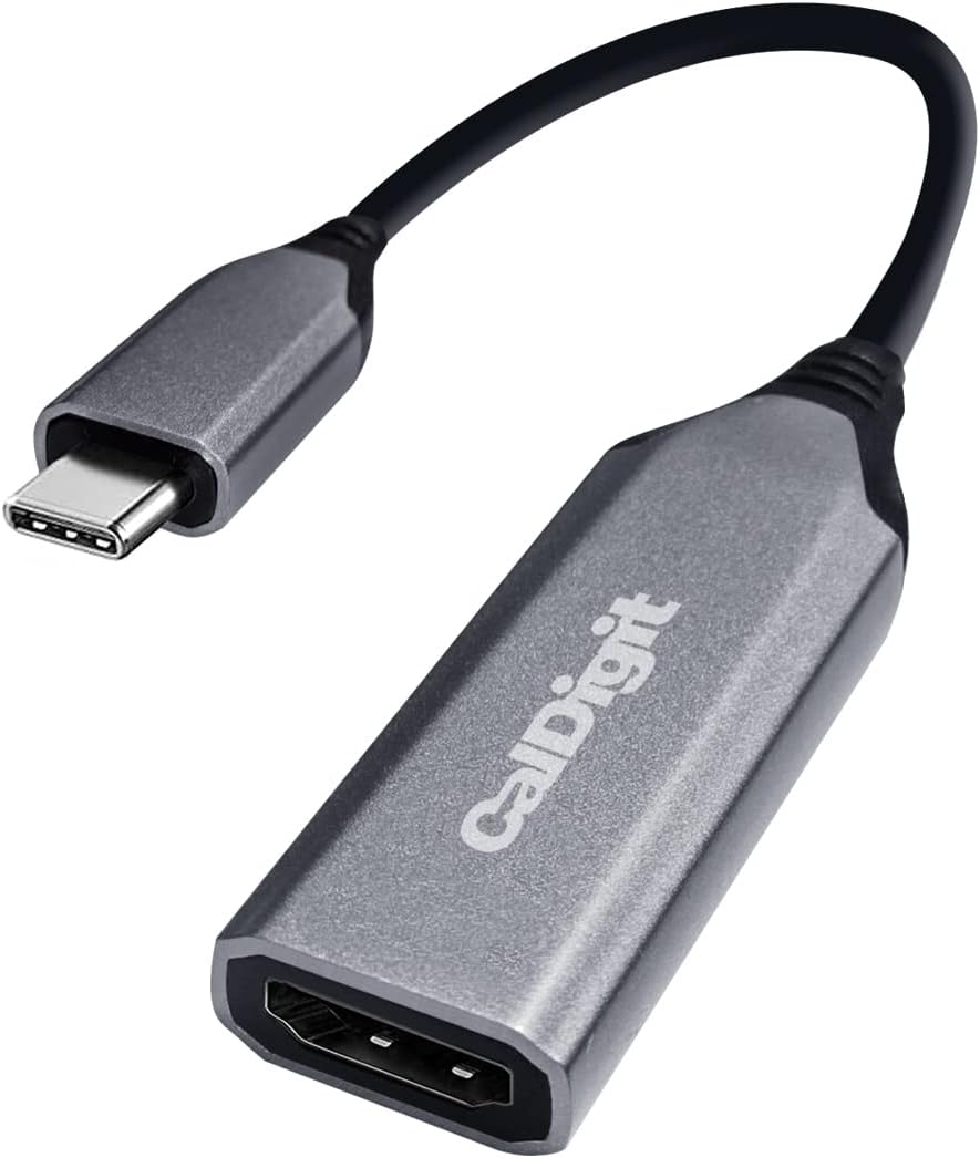

I believe this is the one that finally gave me 4k/120hz at a lower bit depth.
For anyone else interested, if you care about VRR/Freesync, this adapter might not be able to do it. That was always my hangup when looking at adapters.
