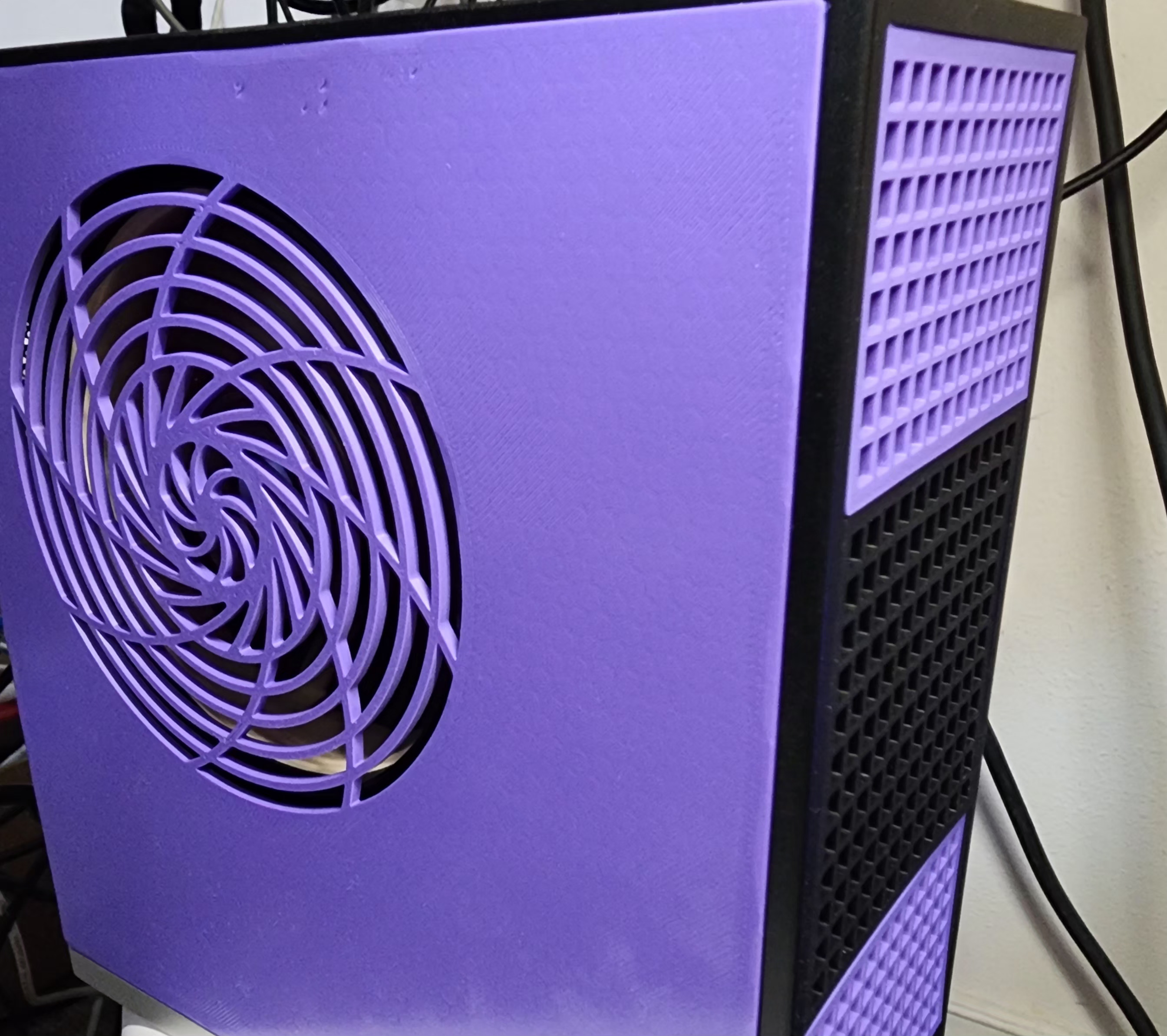

I installed my Noctua 80mm as an exhaust. I haven’t measured but it certainly moves some warm air out under load. I printed some very open front panels partly because I liked to look and partly for airflow. I don’t mind the warm air out the front and thought it would move more air that way than fighting the other fan. If I had the OEM panels I would maybe go the other way since they seem more restrictive.
Nice !
Really makes me want to get some sort of 3D printer.
