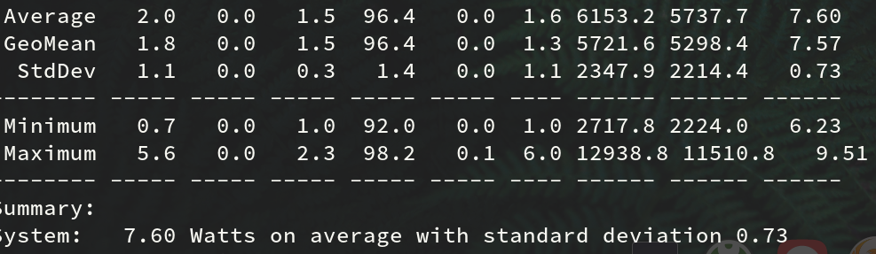

That’s a little better than what I’m getting at idle on my Elementary OS (Ubuntu) installation, although I have the 7640. I’ll get around 6 hours of battery life. Hoping we see some efficiency gains in the future. Battery life is pretty lacking from what I was hoping for.
