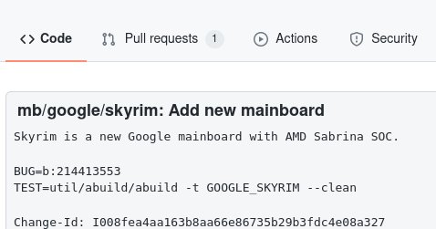

It is worth mentioning that Coreboot code seems to exist for Zen3 and seemingly for Zen4 CPUs (though that remains to be seen; for all we know it’s for Zen4c), yet not for Zen3+:
