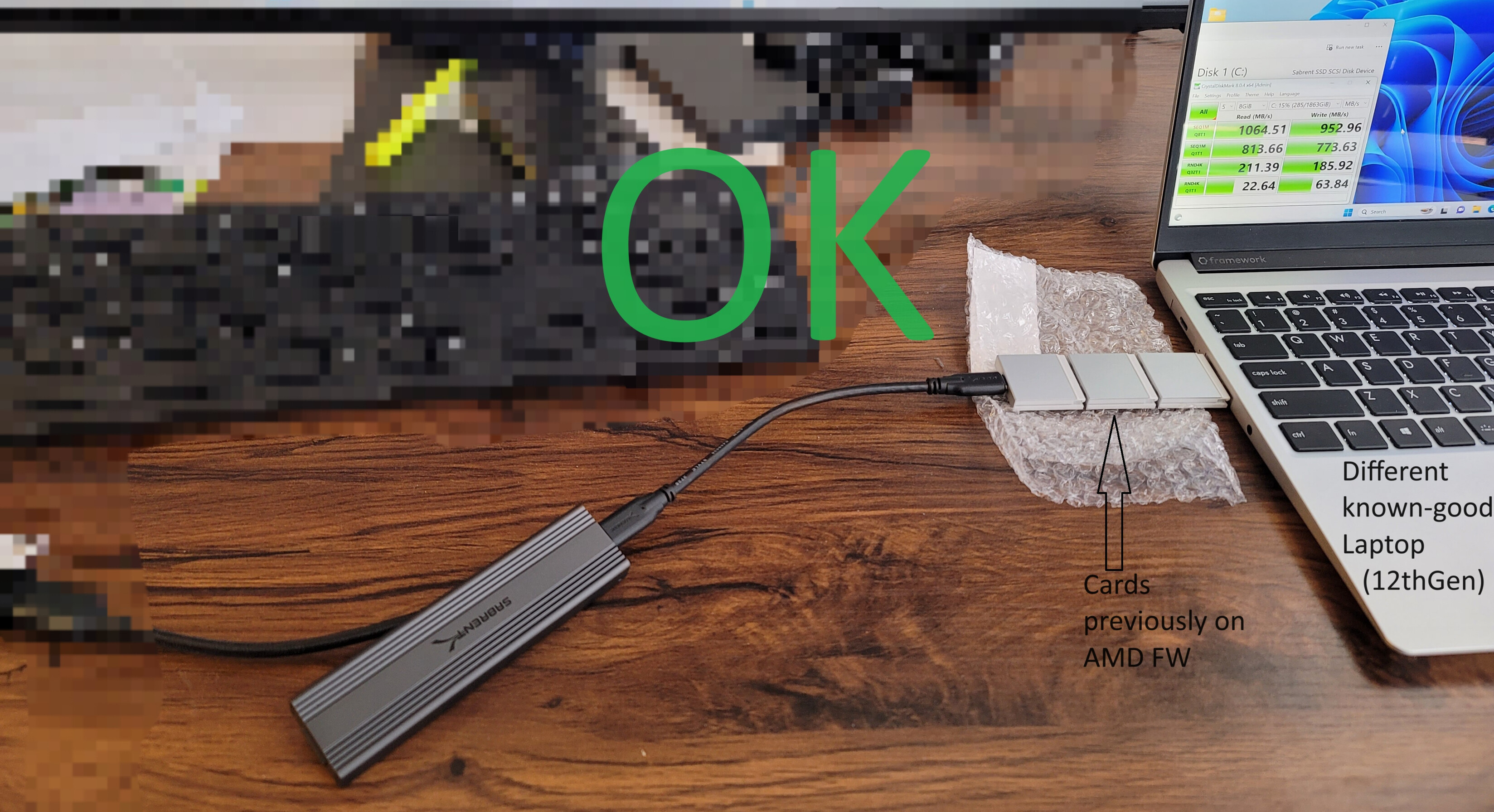

I wanted to replicate this. Filled up a 64GB microSD with large files. I wanted to plug the microSD card and Sabrent enclosure both into the AMD Framework, and copy large files from the microSD card to the external NVMe SSD via AMD Framework. Unfortunately, for some reason the Sabrent enclosure isn’t being recognized at all now. (microSD in card reader popped up immediately)
Section Update 1: Got it to work. USB3 card reader, but the card isn’t capable of exceeding ~90MB/s read, therefore the external SSD isn’t getting more than ~90MB/s write, obviously. Copy lasted under a minutes until the external SSD dropped again. Seems like a low write speed in this scenario doesn’t mitigate the disk drop. (Interesting how when the drive is erroneously slated as 5Gbps upon connection, it was able to finish copying a bunch of large files at a much faster 500MB/s)
When the AMD FW enteres the state of ‘cool down’ right after a disk drop, the external drive won’t even show in the BIOS boot selector. (the disk is bootable, and will otherwise show)
I’ve also worked to rule out the possibility of defective Type-C pass-through Expansion Cards. Plugging the external drive directly into the board with no Expansion Card doesn’t eliminate this issue. I’ve also pulled Expansion Cards off the AMD Framework, linked them back-to-back, plug them into my 12th Gen, connected the Sabrent Enclosure and smashed it with both large file transfer and synthetic benchmark. Works fine.
Yup. It’s about time I really ought to pack up this specific unit of AMD FW and ship it to them. When I email Framework to inform them the tracking number once I have it, I’ll also mention this behavior we are investigating, so if they wish, they can grab this unit for their own testing. Again, if anyone from Framework is reading, I can also provide my enclosure/SSD/cable.

So I just tested in Windows to see if I could reproduce your stated “cooldown period” and I could not, with CrystalDiskMark or transferring a large file. After it disconnects it then reconnects immediately (the same behavior I’ve been seeing on Fedora and Ubuntu).
Also I can confirm, that for Windows USB Device Tree Viewer confirms 5Gbps (SuperSpeed) or 10Gbps (SuperSpeedPlus) under Device Connection Speed. When it negotiated at 5Gbps, CrystalDiskMark was showing around half the throughput vs. what it was at 10Gbps, and Device Connection Speed said SuperSpeed instead of SuperSpeedPlus.
When it was connected at 5Gbps and working with CrystalDiskMark, I let it idle and it went into the breathing blue LED/power-saving mode. When I ran CrystalDiskMark again and it came out of that mode, it stayed connected at 5Gbps, worked as it usually does when it’s connected at 5Gbps in my left bottom port, and did not renegotiate to 10Gbps.
So I couldn’t reproduce that either.

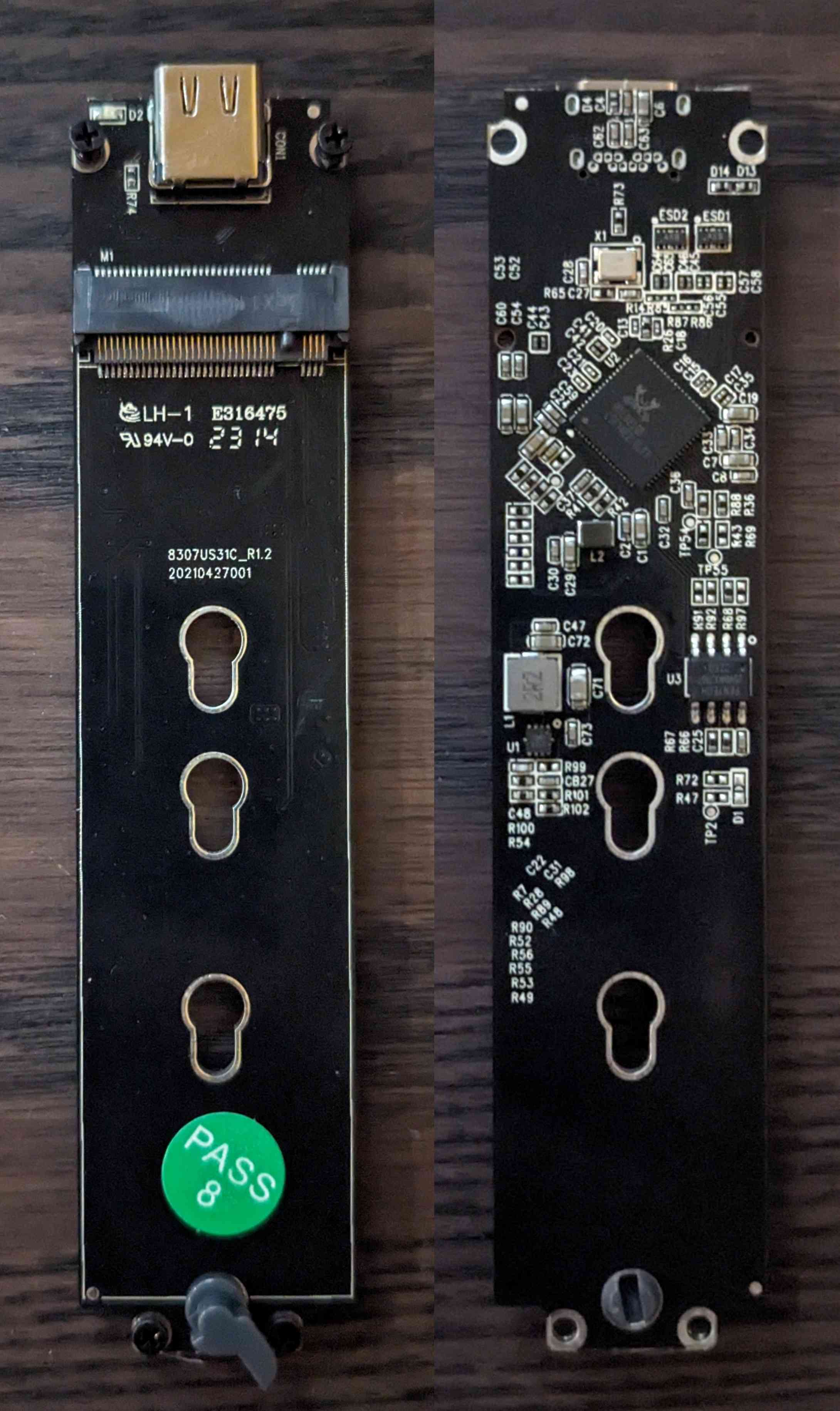

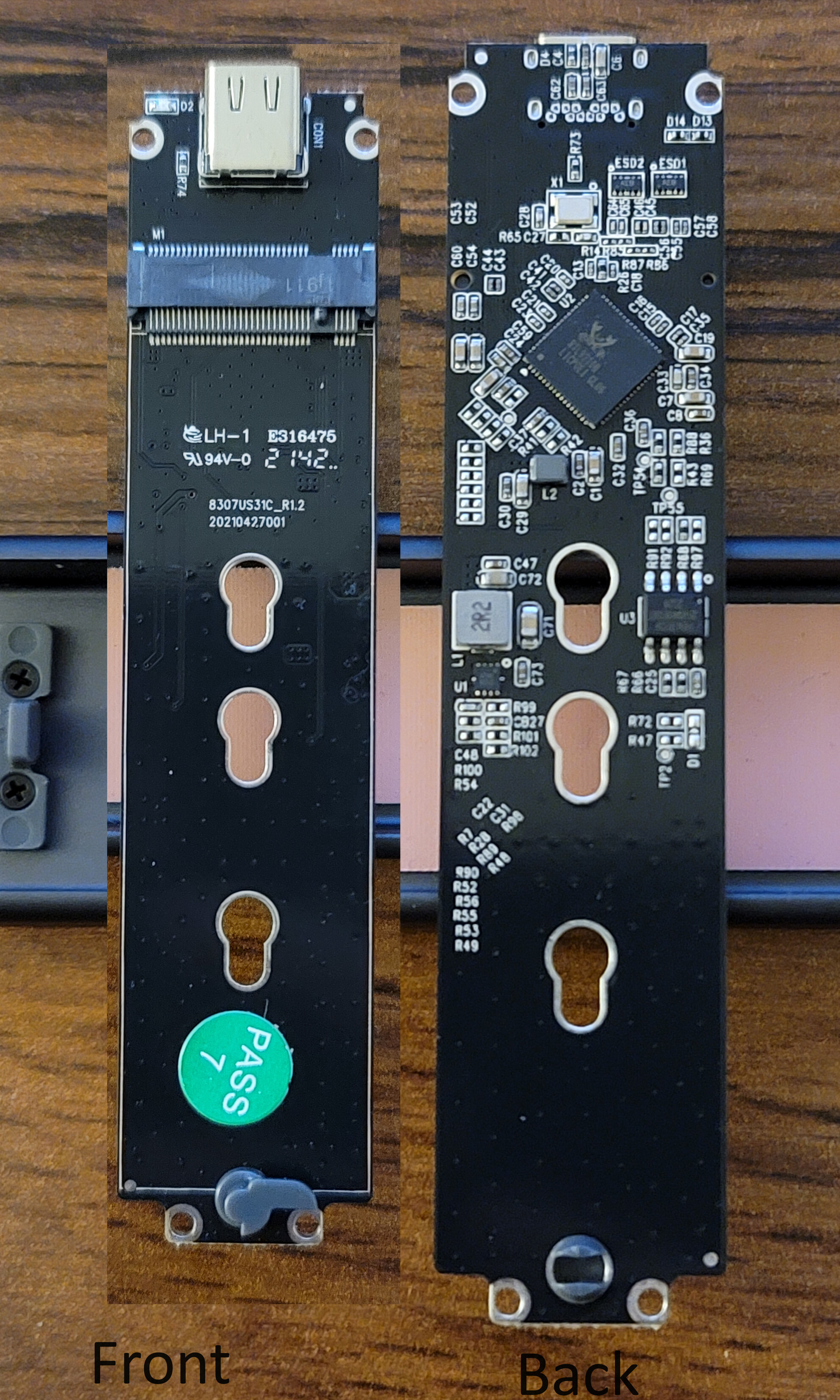

Maybe that’s just my phone. But, what revision of the EC-SNVE enclosure do you have? I’m extremely sure there are multiple revisions under the same ‘EC-SNVE’ model. They do appear to have the same controller, but with different 2280 clamping mechanism and visibly different components arrangement on the PCB.
This is mine.
Although we are on the same firmware, it’s still possible that we have different revisions of Sabrent EC-SNVE. If there’s indeed a revision difference, that may or may not be related to the somewhat different malfunctioning behavior we are observing, and differences in phone compatibility. But, in any cases, I doubt either of our enclosure qualifies as ‘broken’. After all, this enclosure works completely fine with my particular unit of 12th Gen Framework, my 2017 (A1707) MacBook running Windows 11, and few other computers.

Here’s a pic of mine, it looks like the clamping mechanism and PCB arrangement are the same, as well as 2 lines of text on the front beneath 2142 on your photo (2314 on mine).
wrt to the rest, yeah, and thanks again for making them aware. By the way, how’s the enclosure/SSD with your replacement?
Thanks for the enclosure teardown, I’ll compare more carefully later, to check for any difference. Update: Compared side by side. Seems like we both have R1.2, all surface mount components appears to have identical placements.
