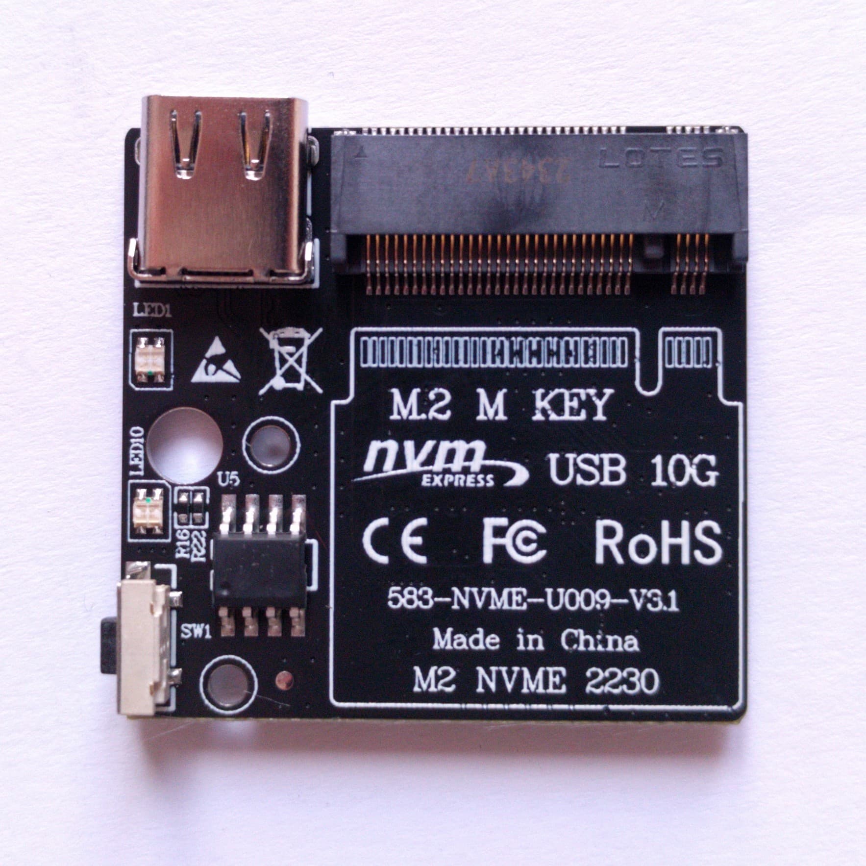

Hi ! I came across this thread and thought I could share my experience.
My setup
  • Laptop: Framework 13, AMD Ryzen 7 7840, BIOS 3.05.
  • NVMe/USB enclosure: ElecGear EL-2230C, JMicron JMS583 inside.
  • NVMe SSD inside the enclosure: KIOXIA KBG40ZNS256G, known reliable and used as a boot drive for a few years without any issues.
  • SATA/USB adapter: Sabrent ASM1351, paired with a Samsung 850EVO SATA SSD.
  • Cables used: All known/confirmed good, tested multiple 2.0 and 3.0.
I use Windows To Go on a regular basis for gaming with the SATA/USB adapter and SSD. I find it convenient to separate my work space and my gaming space.
PCB view of the EL-2230C
Fault observed
I tried Installing Windows to Go on the EL-2230C (Windows 11 Pro) with a software called Rufus. I applied the image either from the Framework Laptop itself (from a Virtualbox VM) or from a Windows To Go (Windows 11 Pro) install booted from a SATA/USB Drive.
Depending on the case, I always end up with a corrupted image on the EL-2230C:
  1. Rufus fails to apply the full image to the disk and drops an error message.
  2. Windows To Go BSOD on start because of corrupt files.
  3. Windows To Go fails during OOBE because it corrups itself.
  4. Windows To Go fails after a few minutes of normal usage and does not to boot anymore: unrecoverable BSOD on restart like case 2.
This behavior does not occur at all with a SATA to USB adapter. I tried cloning my daily (known good) Windows To Go image from my SATA drive to the EL-2230C, but ended up in case 4 in only a few minutes.
