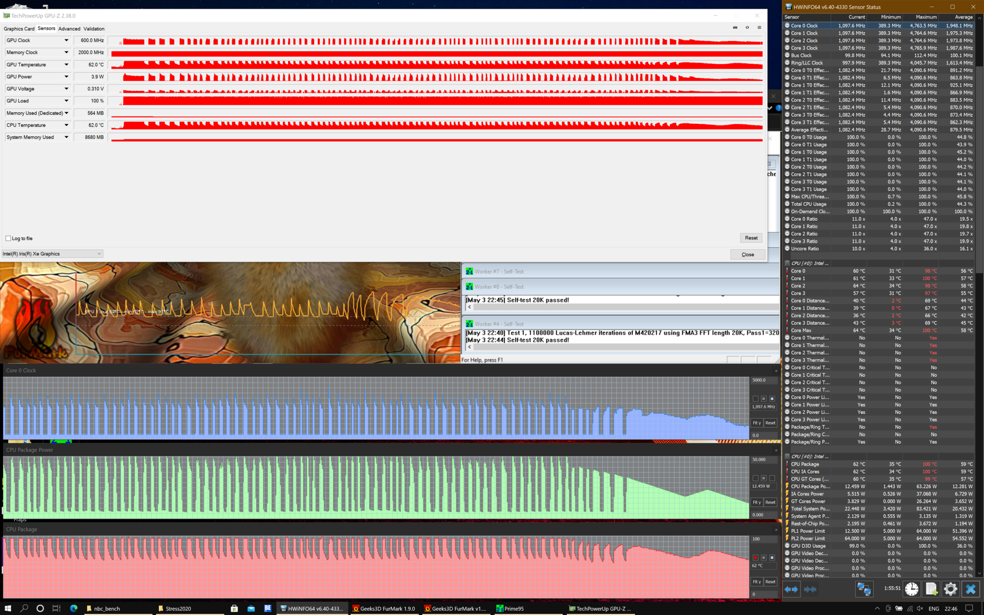

FYI I did all benchmarks and performance analysis on latest BIOS. The previous issues that Notebookcheck reference were much much worse (stuttering on Zoom, YouTube, and games from the 90s) before BIOS updates.
The 15W-sustained is after updating everything, and that’s what I am unsatisfied with. I even tried unlocking power limits via ThrottleStop and would get a thermal hard shut-down trying to get it to run at 18W sustained. So regardless of software issues, the thermal capability is quite bad.
