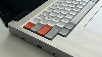

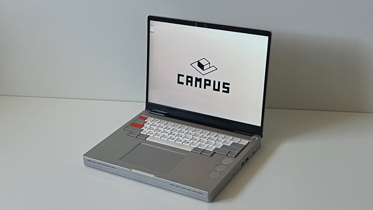

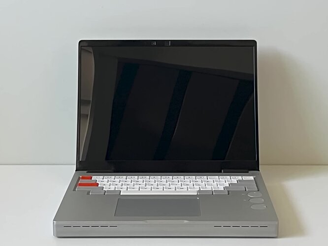

I just wanted to share the latest project I’ve been working on: the Campus, a completely redesigned Framework 13 to house a gasket mounted mechanical keyboard.

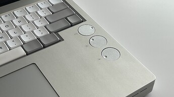

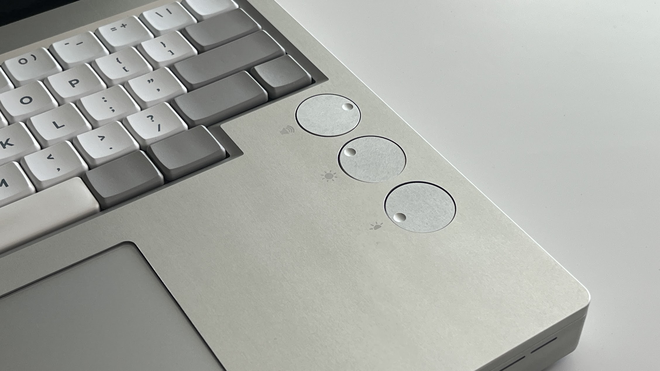

This design keeps most of the fun features found on the Framework 13, for example, compatibility with the expansion card slots, but adds a few new ones, like the built-in rotary encoders to adjust volume and brightness.
Check out the video above if you’re interested in seeing the build process!
