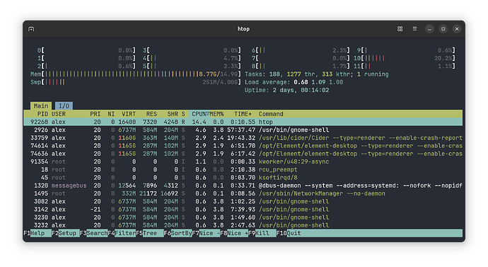

Just going on the basics, no particular insight here:
  • Run htop (install if needed) and enable view of kernel threads too (see man page). Anything using a lot of CPU there?
  • Anything interesting in the kernel logs? journalctl -k or journalctl -k -f to watch it in real time.
That looks quiet from my perspective… Or what I call - idle machine.
Nothing interesting in journalctl as well - as of the moment of writing, last message has been like 10 minutes ago on adapting WiFi to the signal/noise.
btw - htop’s kernel threads could be enabled via TUI’s setup.
Unless you see something that I miss here?
