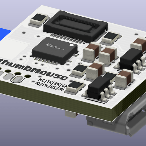

Do you remember the pointing device on the Blackberry Bold? Some versions had a tiny trackball, and some versions had an optical sensor, basically an optical mouse flipped upside-down so you’d slide your finger over it, and it would track the motion of your fingerprint features just the way an optical mouse would track the motion of the desk underneath.
This allows a gizmo about 12x12mm to act as a full mouse. That plus a BLE radio and battery should fit into an expansion card form factor no problem. See here:
