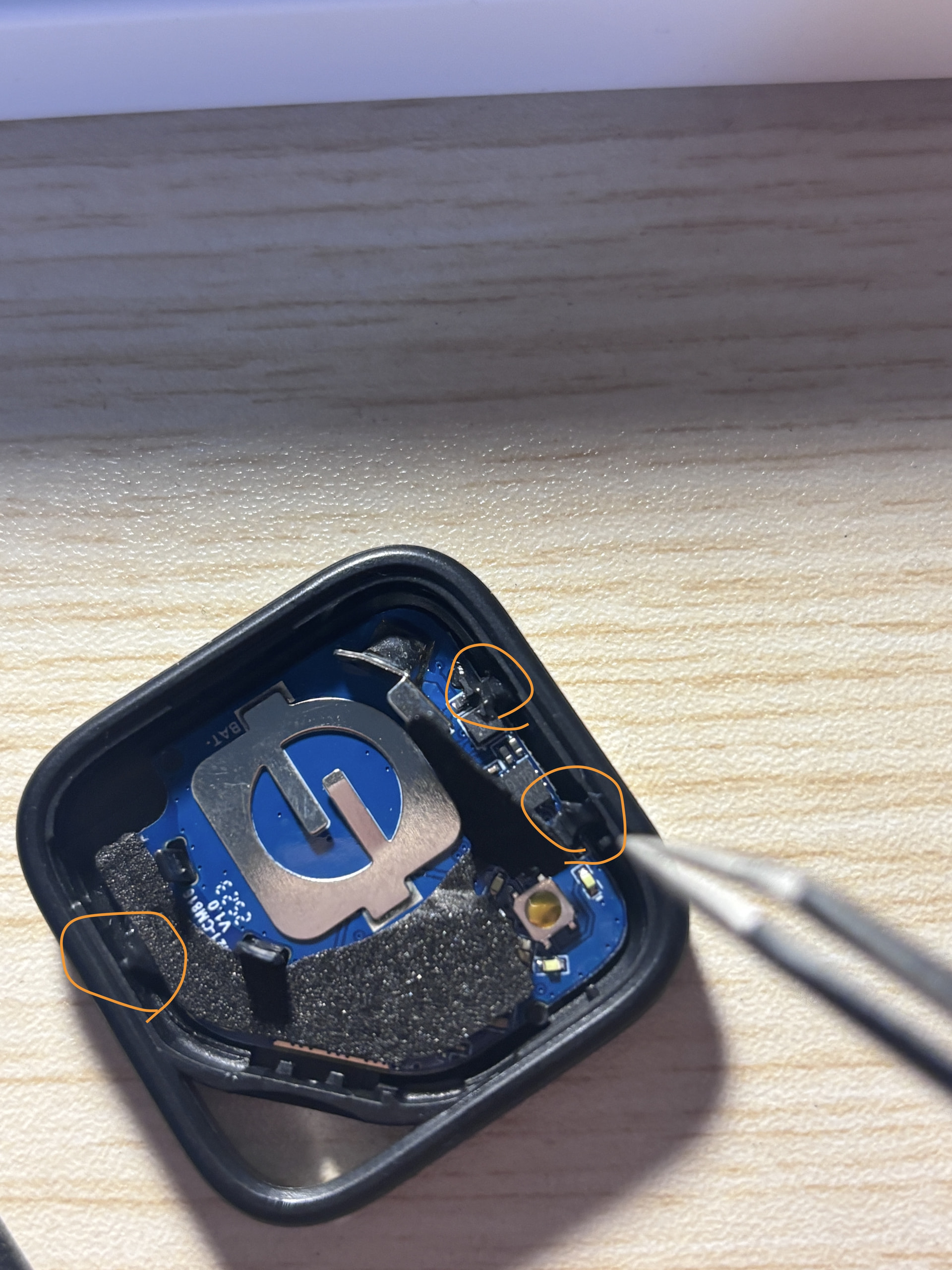

Once you pop the cover off using the included SIM card ejector tool, the PCB is visible right away. It is secured by three plastic notches that feel almost like hot glue residue, so I just used metal tweezers to chip them away.
Then I carefully lifted the PCB out. This is where I lost the speaker functionality, because as you can see from the previous photo, the speaker’s metal plate is glued directly to the casing. I’m not entirely sure if there is a clean way to preserve the speaker.

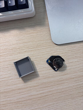

I printed all the model files from this empty expansion card design on Printables, and I ended up using the “Framework Module Base”.
I secured the battery using a small strip of electrical tape, and it clicked into the expansion card backward.

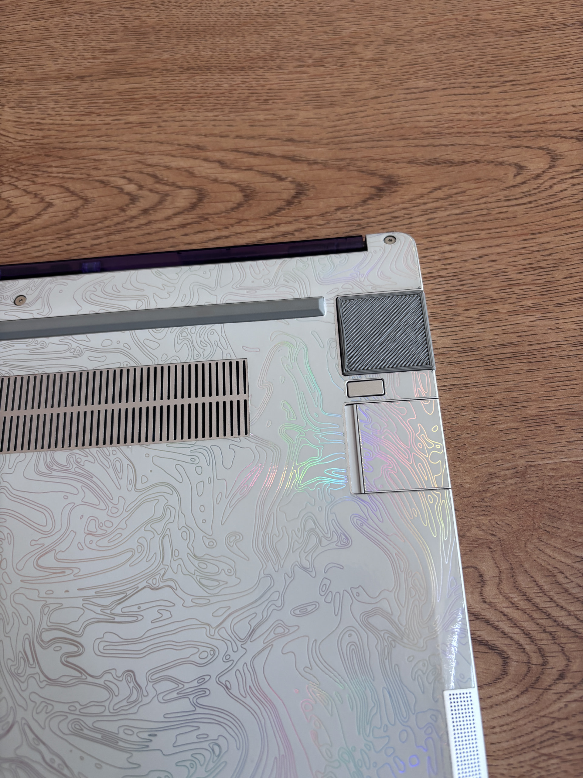

Here are a few more photos from different angles.

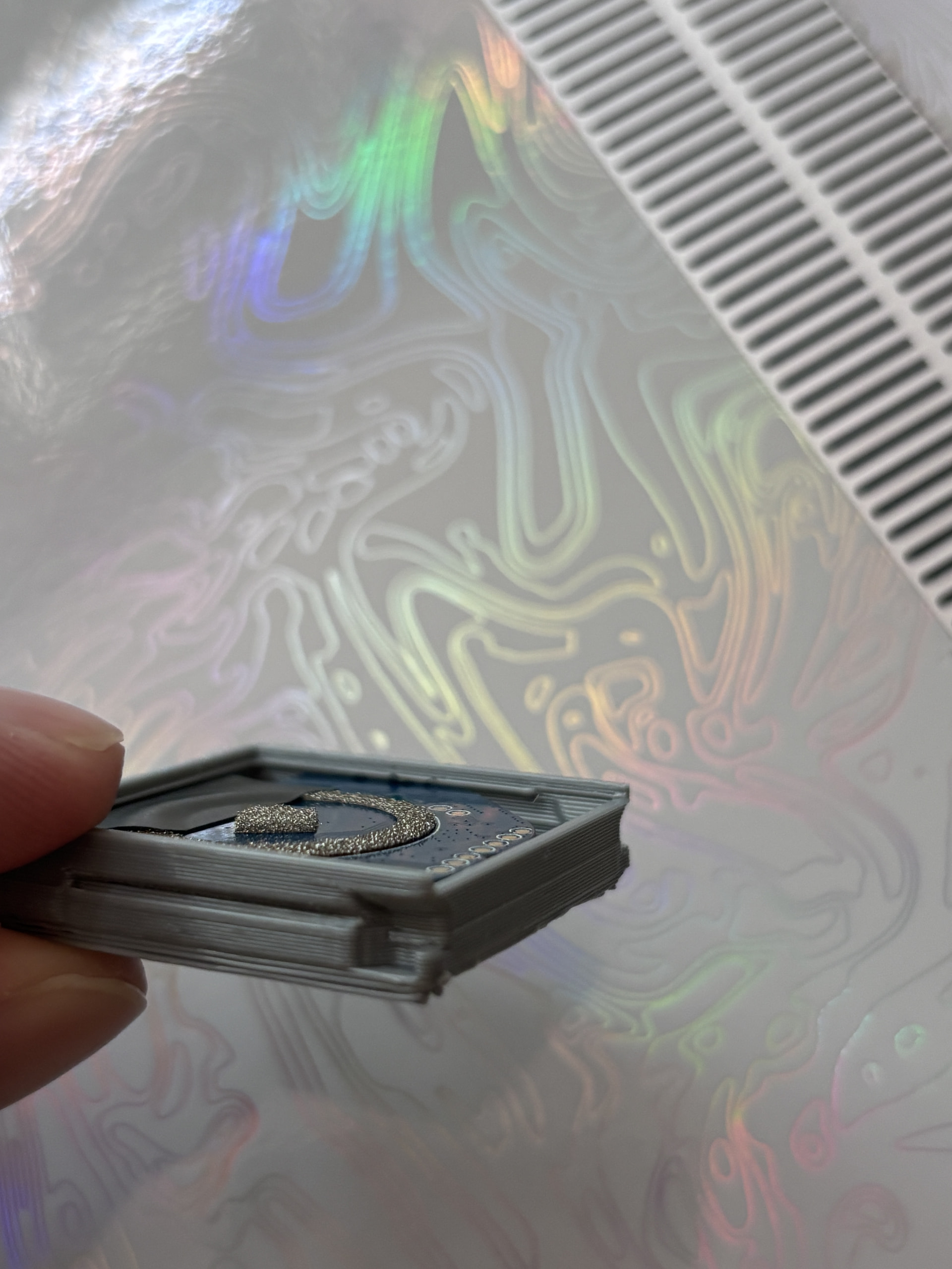

Now for a big asterisk: since I am by no means a 3D printing expert, I just downloaded all 8 files from the Printable link (along with other empty expansion card designs) and submitted them to my college’s 3D printing service. I suspect they used cheap filament, because most of the printed cards didn’t fit at all. Even the one I ended up using was a very tight squeeze. It only actually fits in one specific expansion bay on my laptop that seems to have slightly looser tolerances; I actually had to pry it out when I accidentally tried pushing it into a different bay.
The bottom line is, I’m not entirely sure if using a more precise model or a higher-end 3D printer would make this fit better or worse, but it’s something to keep in mind.

Unless they use very cheap filament, that’s unlikely the problem. I suspect that the main issue will be the layer height. If you can ask them to lower the layer height to 0.15 mm or at most 0.2 mm, then the rails along the sides will be a closer match to the model and not bulge out as much.
That being said, because of how the bottom of the print looks (I can see that they printed this on what’s called a “raft” a large thin area below your print that detaches), the printer they are using is either somewhat low quality so requires extra help to get the print to stick, high quality but old (often automatically apply rafts), or the person running the printer was just worried about the print coming unstuck for some reason.
