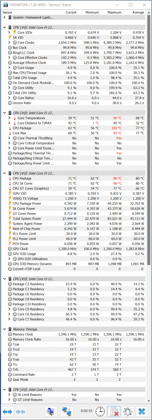

Looks like your system didn’t go into boost while benchmarking. (Max CPU Package Power was only at 30W)
Is it plugged into the wall, and set to Performance power profile?
This was run on battery and I believe the power profile was Balanced.

I think the interest from most will likely be “best performance” but your CPU it at 60W PL2 in that screenshot which is the main thing I believe. You also got quite close to peak wattage at 56.2 nice to see. Thanks again for these.
