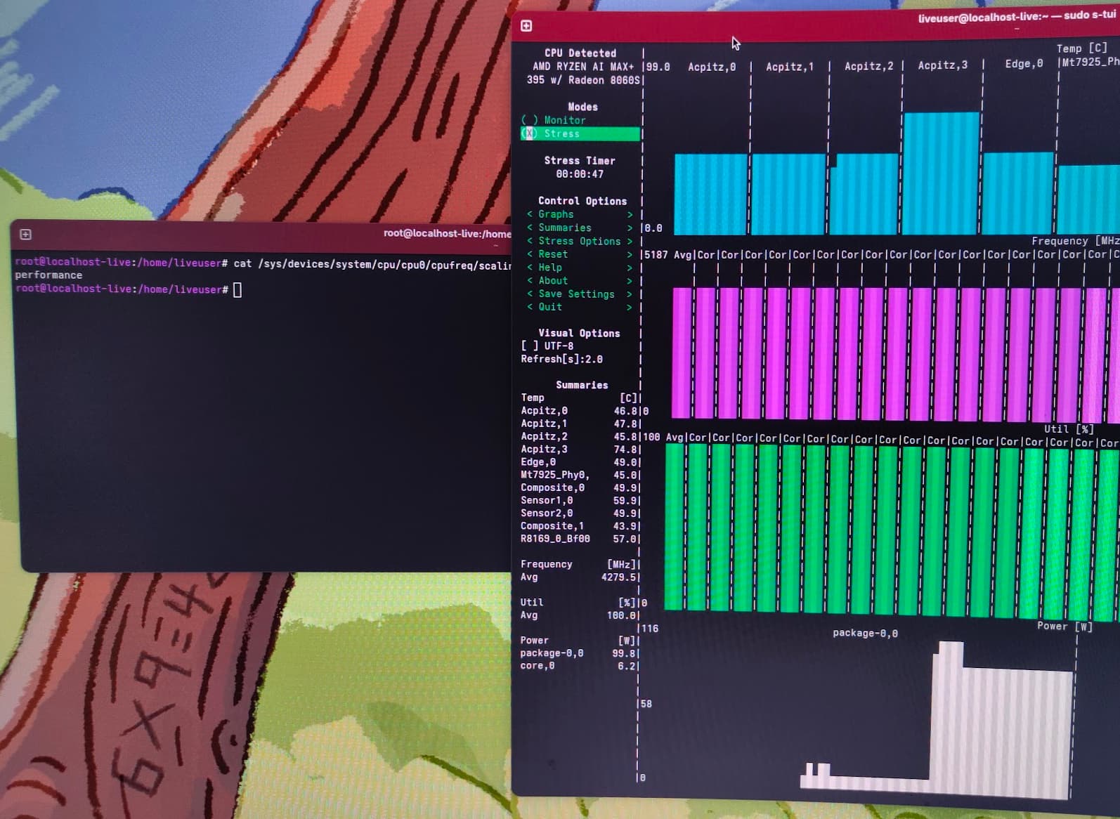

To rule out something OS related I booted a Fedora 42 live environment and tested with s-tui. Same behavior: 115W boost that drops to 100W.

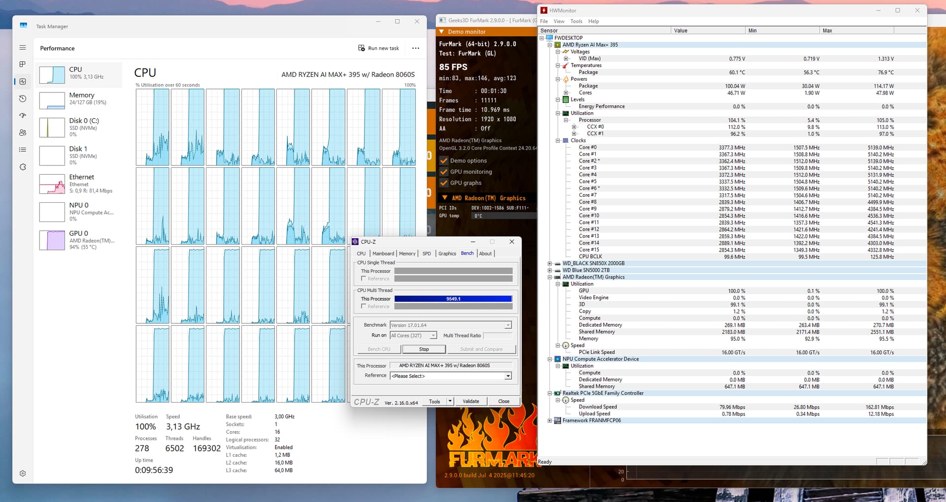

During 3DMark Timespy the APU boosts up to 115W, drops to 100W.
Loading with cpuz and FurMark .. same 115W with a drop to 100W.
LMStudio with a 16/24 layer offload .. 115W with a drop to 100W.
Loading with 18 EVE Online clients .. boost to 115W and settles in the 100W range.

Have you changed your cpu governor to performance or is it still on balance? That could explain the difference.
The version of Strix Halo in laptops is generally ran at considerably lower power limits than this, so even if we believe these are the actual power consumption numbers, the real world performance should be considerably better than the laptop counterparts.
Thank you for the response.
As you asked about the cpu governor I assume you ask about it in Linux. I rebooted into a Fedora live environment, default was set to “powersave”. Changing it to performance did not make an impact .. please excuse the screen photo:
