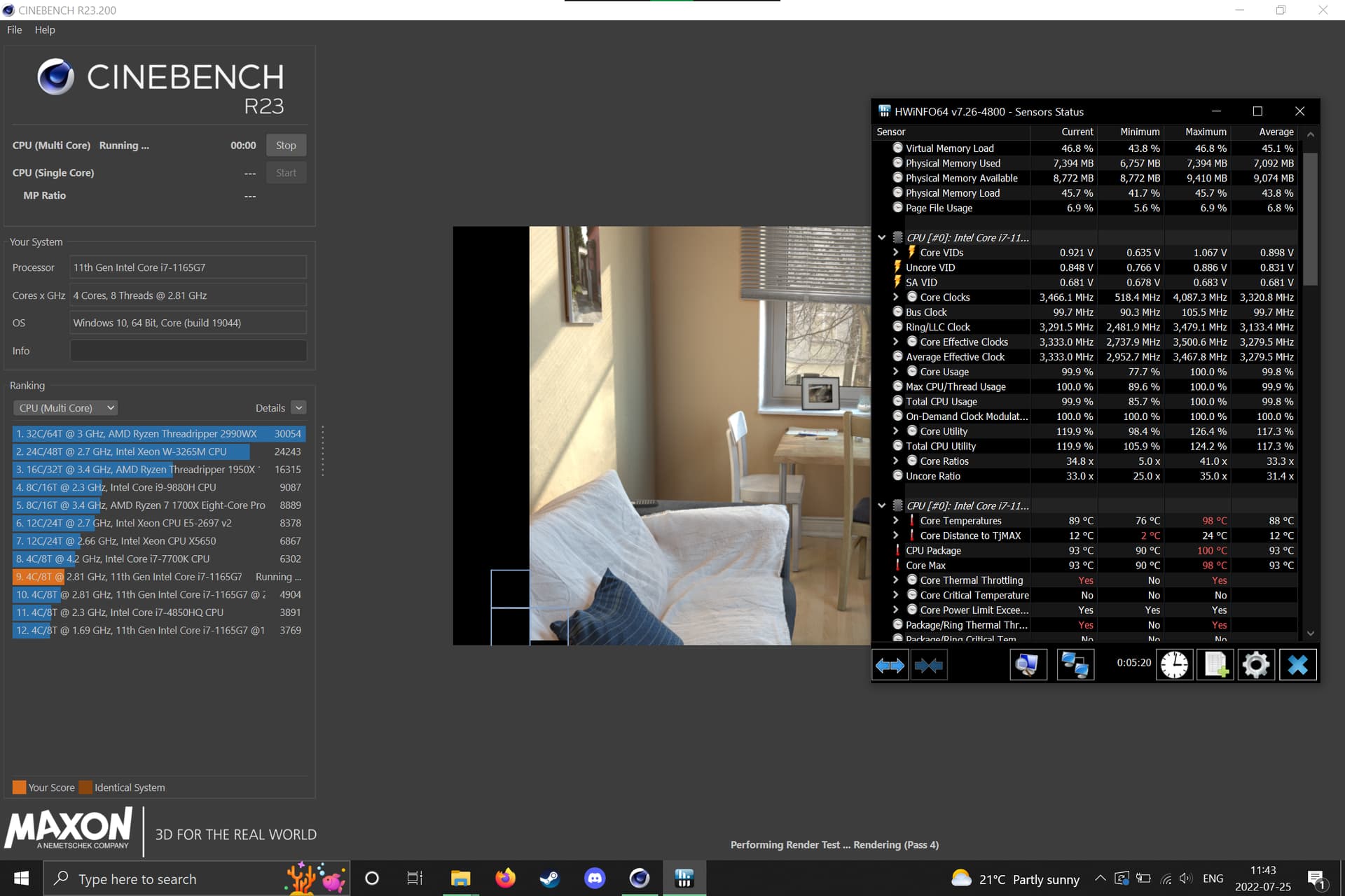

I ran Cinebench R23. I got a score of 5017, which is similar to the built-in i7-1165G7 score, but the fan was running wide open, seemed (subjectively) to be making the sound fans make when they’re not getting much resistance, and the CPU hit 100 degrees.

Your Cinebench scores seem on the lower end.

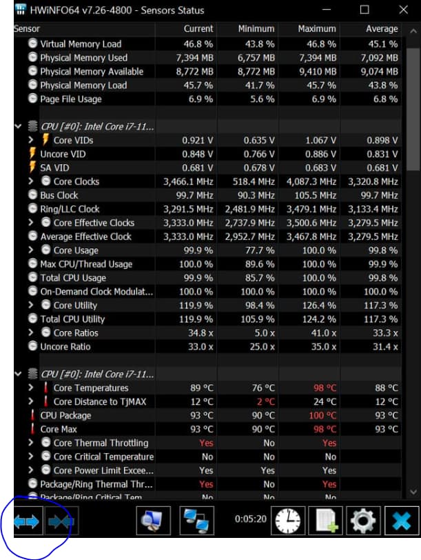

I don’t see what you’re referring to. This is what I see when I start the program.
He/She meant this icon:
Click on it…and hwinfo will go wide.

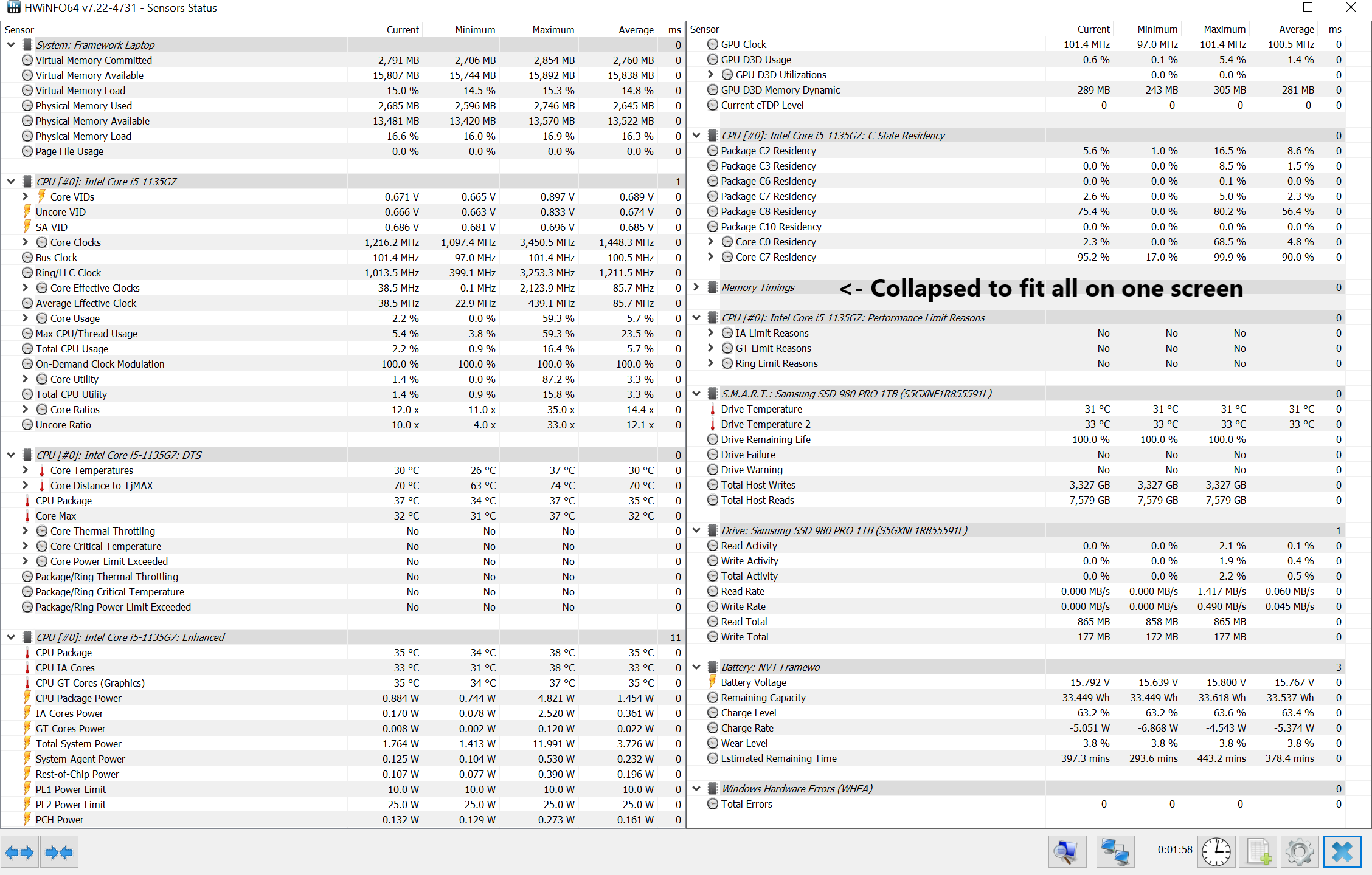

@Second_Coming is correct but I see the reason for confusion now. When you start HWiNFO64 you can tick the option to launch just the sensors
Then expand to two columns with the blue arrows and I suggest collapsing memory timing so you should have something like this
Here you can see a lot about your system.
