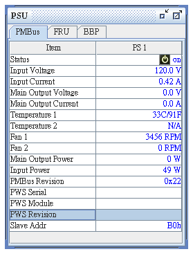

I run a DPS-400AB-17B in my system, with PMBus.
It has complex fan curve behavior, however its … very weird. At first it might appear to be just “go to 100% whenever the power supply go to 60C and go to 10% when the PSU go below”, with a extremely slow change (20 second) in between.
I imagine its a similar thing FSP use, given from your description. However on at least one unit from me it’s different.
more fan talk
Say the system will enter a “95% slow 5% fast” cycle. If you leave the system on for like a day and come back, the fan will be .. somewhere in between, like 20% or 25%. I think the IC take a average, but it resets when it turns off.
Curiously this behavior seems a bit different with and without PMBus. It could also be that the two (used) 400AB units I received were customized by different OEMs, as one of them dont seem to exhibit this behavior. I will have to observe more closely.
The fan noise spectrum is not really something you can easily change, though. Best you can do is to swap out for a fan with a lower RPM. The stock fan in my 400AB is 10K rpm, and replacing it with a 8000 rpm (albeit, sleeve bearing counterfeit) dropped the peak noise by 4dB.
