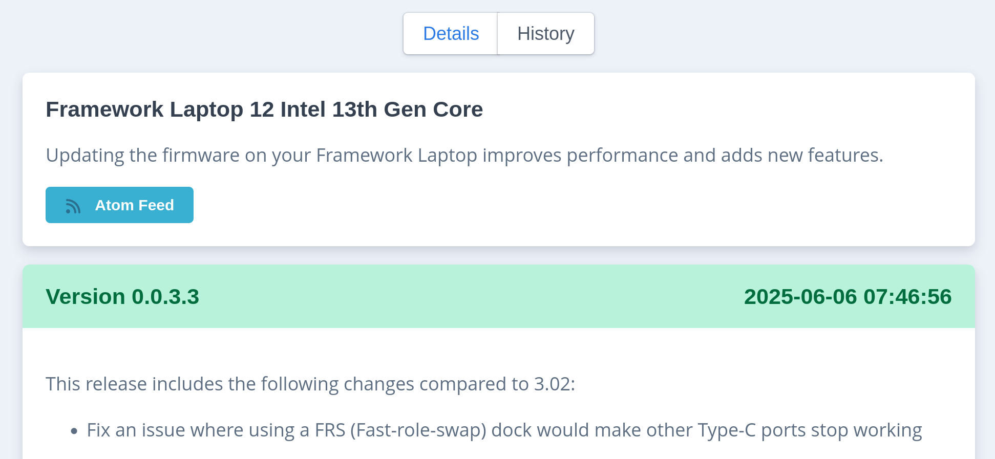

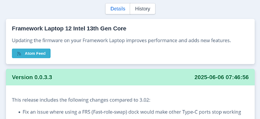

Answering my own question here.
It seems version 3.03 is the most recent version on LVFS (at the time of writing*)โ€ฆ
*Before some smartass shows up on Monday posting โ€œyour link points to version 3.04 you dum-dum!โ€.
Good catch! Thanks for investigating it!
I took the screenshot on the above-linked page as evidence to assist you!
