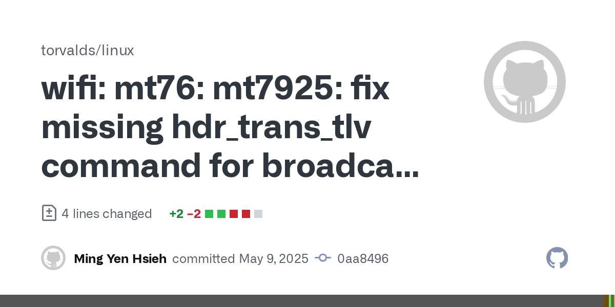

I’d recommend running 6.15 if you can. A few MediaTek fixes are included, e.g. the following fix for broken IPv6 & mDNS
