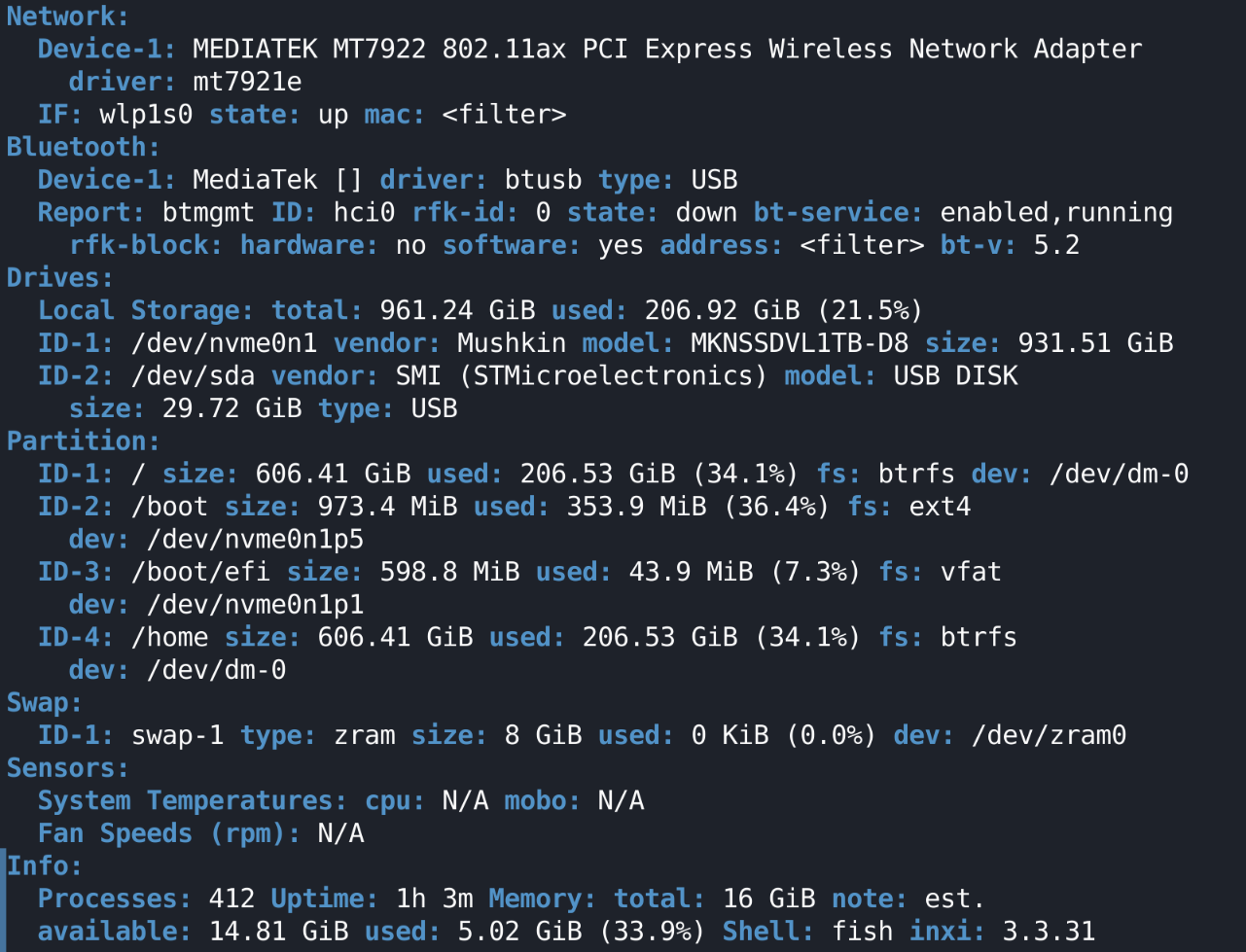

For about 2 weeks I’ve had problems with intermittent WiFi disconnects on my FW13 running Fedora 39-KDE Spin. Typically, after using the laptop for 10-30 minutes, the wifi will disconnect then reconnect every few minutes. Eventually it disconnects and can no longer detect any nearby routers. Rebooting restores normal behavior.
I used Btrfs Assistant to restore a snapshot from 2 weeks ago and used GRUB to choose a 6.6.6 kernel to get my wifi working again. Later I did updates, and tried the 6.6.9 kernel which brought back the regression. I restored back, am using 6.6.7 (the 6.6.6 option disappeared). Things are currently back to normal. (More info on my system are at the end)
What now?
Do I periodically run the system update, cross my fingers that the regression’s fixed, and restore a snapshot if not? Do I report this to KDE and/or Fedora?
More info: I tried the officially supported KDE-Gnome live USB and the wifi worked fine. Interestingly I tried a Manjaro-KDE USB and it did have the wifi problem. I was curious and installed Manjaro on a microSD, updated it (including 6.6.8), and there were no wifi drops.
BUT the wifi on Manjaro was stable but slow. On Fedora my speedtest.net download is 1200Mbps but with Manjaro it was only 300Mbps. Maybe the fact Manjaro was running from a microSD was the reason. I’m not an expert on the various wifi protocols and Ghz but I’d be interested in an opinion on this. My router/modem is an Xfinity 6E model. I’m in an apartment complex with 10 networks visible.
My inxi -Fz is atttached below.

y inxi -Fz

Absolutely the best course of action is to file a kernel bug with Fedora. It’s not something I have experienced myself, but, clearly a regression is happening.
Just out of curiosity, what is the last line of output from:
sudo dnf install iw -y && for interface in $(iw dev | awk '/Interface/ {print $2}'); do iw dev "$interface" get power_save; done
Curious what your power save status is.
We did have some updates hit with Fedora dealing with the bug described here. This dealt with a different issue, I wonder if this change is reflected in what you’re experiencing. This bug fix dealt with slow wifi issues with the Mediatek card.
Now, all of this aside, you have clearly shown the change if the kernel creates or resolves the issue. Please file a bug report with Fedora, tag me here once this is done and I will then ping the needed folks to be aware of this.
Pasting that command doesn’t give an output, just a blank line with the cursor in the middle of the line. I’ve let it run for a few minutes and I have to ^c to get out of it. Oddly, it doesn’t ask for a sudo auth.
I had switched my power management option in KDE settings to “performance.” I think this does reduce the problem, but not eliminate it. I’ve gotten kind of sick of doing the updates and restores, hoping for improvement. I’m going to install Ubuntu LTS to an SD card and try my luck with that. I’ll file a Fedora bug in the near future.
Hmm, regardless of desktop, on Fedora, it absolutely should have worked fine. Appreciate the update on events. For this to simply stop like that tells me something is definitely wrong with the configuration.
SD card behavior should work, however I’d avoid suspending on it as this is untested on SD. Likely won’t resume.
Do make sure to follow the guide, ensuring your on the absolutely correct kernel (very important) and all the steps are followed step by step. From this link, steps 1 and 2 are important.
Ideally, we want folks using Fedora Workstation (GNOME) using the guide, or as you have indicated, using Ubuntu LTS using the guide steps.
I realized the problem with the command you suggested. I’m using fish as my shell and bash scripting isn’t compatible. :stuck_out_tongue_closed_eyes: Running the command under bash gives the last line:
Power save: on
I plugged in to AC and the output was the same.
I installed Ubuntu 22.04 on my SD card and I liked it a lot more than Fedora Gnome. I did make sure to follow all those guides. I used Ubuntu for about an hour without any wifi problems. I think there’s a good chance I will replace Fedora KDE on my NVME.
You were right about suspend with the SD card. It wasn’t a problem with Fedora GNOME but on Ubuntu after waking the login screen was glitchy and wouldn’t let me enter a password. The TTY was throwing a bunch of errors about files being read-only. I’ll assume this won’t be an issue on the SSD.
The Fedora Bugzilla instructions were a bit complicated and I probably won’t sign up for that if I switch to Ubuntu.
I did an install of Ubuntu 22.04 on my NVME, formatting the Fedora partition and keeping the Windows partition.
The wifi seemed fine on the Ubuntu live USB, and and I went ahead with the install choosing the option to include installing needed updates with the install. Looking back at the guide, that might not have been recommended. The fresh install of Ubuntu 22.04 was horrible. The disconnect/reconnect cycle started immediately and got to the stage where there were no detected networks within a few minutes. I was never able to complete the OEM kernel command. The NetworkManager log is below.
As recommended by the ticket I started, I am using Windows as my daily driver today. It seems to be fine for the last 30 minutes.
In summary, wifi was great on Fedora 39-KDE until mid-December. Then something happened and I started having wifi drops using Fedora-KDE, Fedora-GNOME, Manjaro-KDE, and Ubuntu-GNOME. The live USBs for all of those worked fine, implying to me there was a regression last month in something shared by those distros. Windows seems fine. That sounds like a software problem but I don’t get the impression other people are having this problem.
I’ll hang out on Windows for awhile :nauseated_face: but I’ll retry the Ubuntu 22.04 install and try doing the OEM kernel before doing the updates.

Sorry, it seems to be getting worse. I confirmed the 3.03 bios, I confirmed I had the 22.04.3 iso and reinstalled. The install connected to my wifi fine. After the first boot into the new system the wifi now isn’t working at all. “No Networks”
I don’t have a great way to get the NetworkManager log onto my phone, so here’s a pic.
I’ll update my support ticket as well. I’m wondering if replacing my WiFi card would help.
