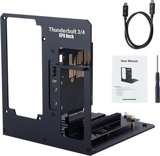

I was looking at this one for starters:

It could be tricky, sorry I didn’t reply right away, work and sleep and life getting in the way. so! you’ll have to figure at what level you are comfortable with setting up eGPU components, ie are you comfortable setting up a completely exposed test setup like the ADT-Link: Amazon.com: JMT ADT-UT3G USB4.0 Docking Station 64G PCIe4.0x4 to Laptop Graphics Card External Conversion Adapter Compatible with Thunderbolt 3 4 : Electronics , or would you prefer a full enclosure with more of a focus on a not as tech-savvy end user like a razor: Amazon.com: Razer Core X V2 External Graphics Enclosure (eGPU): Compatible with Windows 11 Thunderbolt 4/5 and USB 4 Laptops & Devices - 4 Slot Wide NVIDIA/AMD Graphics Cards PCIe 4.0 Support - 140W PD via USB C : Video Games .

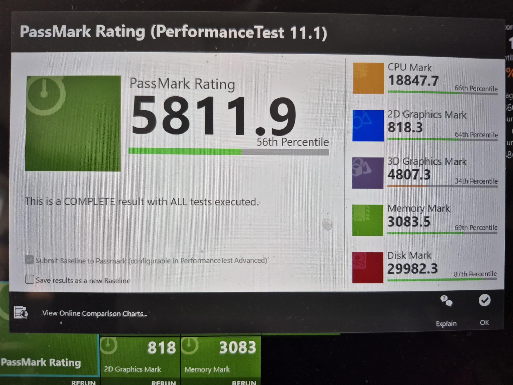

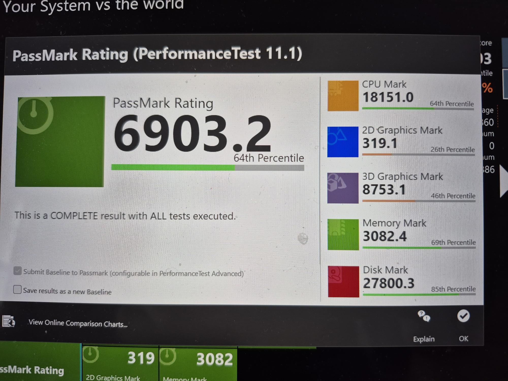

Here are performance benchmark results via PassMark:
Results with only Framework Power Adapter (60W) attached, Max Performance power setting:
Results with GMKtec AD-GP1 power supply attached:**
As you can see there is a significant difference in the 2D mark (is actually lower) as well as the 3D mark (which is considerably higher).
