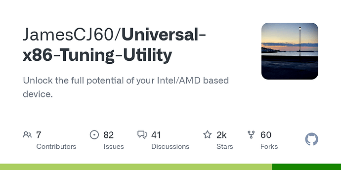

hello im on windows and i don’t know how to make the dGpu use the highest clocks everytime i play a game it will crash and make my laptop restart and i think the issue is from the dGpu not having max power required (im using the 180w adapter) if you can help me please
I am not a Windows guy by far.. I haven’t used one regularly in over 10 years. So… I am probably wrong, and you should research this before making any changes:
Messing with clocks, wattage, and gpu configuration is not recommended if you do not know what you are doing. You can potentially break your laptop if you do the wrong things.
While unlikely with the above tool - you should still educate yourself on the changes you are potentially making - no one is responsible for you turning your $2500 laptop into a paperweight except yourself :slight_smile:
