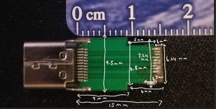

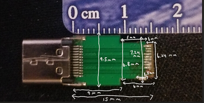

I had mine come in with it’s Male USB-C crushed and I cut it open in attempt to replace the connector. Unfortunately, it looks like I ripped off some solder pads, but it could be useful for anyone else here hoping to still do this project.
Looks relatively simple, almost straight pass-through of the pins. I have access to some calipers and can get some more accurate measurements of everything in the morning if need be.
Yep, if you can provide the dimensions that would help heaps.
@Josh_Cook and anyone else looking to make their own adapter: Here’s what I’ve got. I’ve triple checked all of these with my calipers, let me know if you have any questions.
In total the adapter comes out to 34 mm when fully assembled. The male end reaches out a little farther than the female end does.
