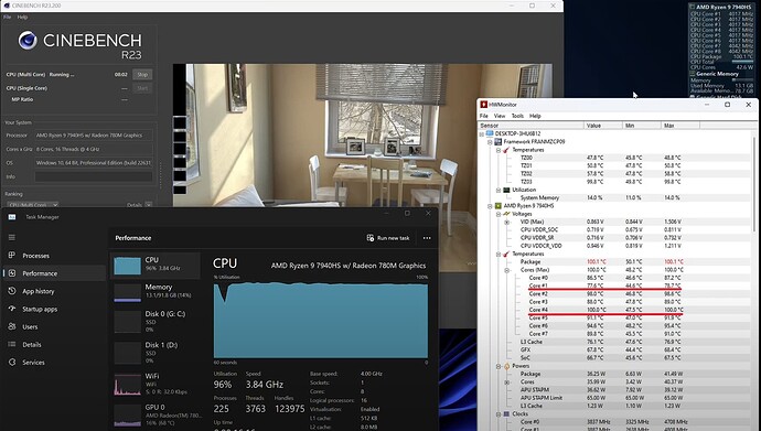

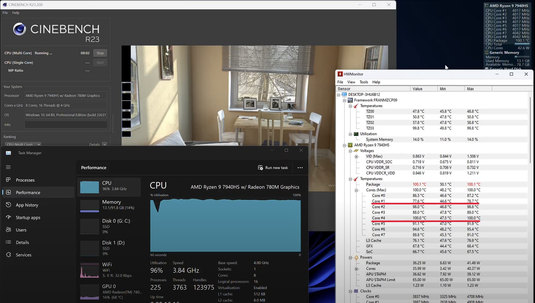

Well my fw is suspended in midair and the Airflow is fully unrestricted. I am even running an eGPU with iGPU and dGPU fully unused to reduce any Heatcomponent which could interfere. And im hitting always the 100C on Core 4 and its always a MaxDelta of 13-15C depending on the Benchmark.

Well my Case is getting escalated. I did provide my Screenshot from above and answered all preliminary Questions. Will see where it goes.

Core #4 is going up to 100C while a different one is only 77.6C.
Temp
Get in Contact with the Support. I got the Answer last Night, that my Board is getting replaced and my Tempdelta was significantly less than yours.
