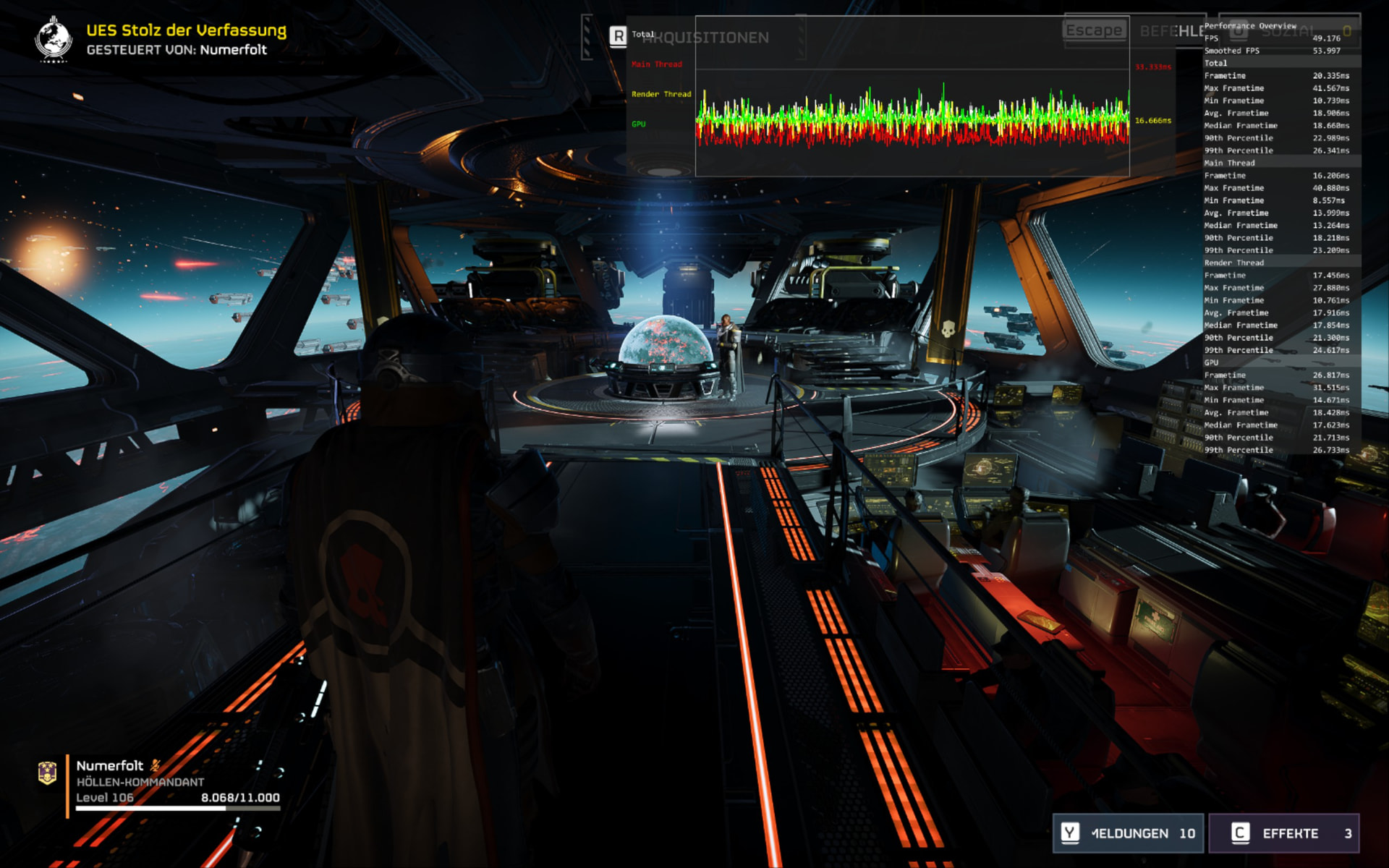

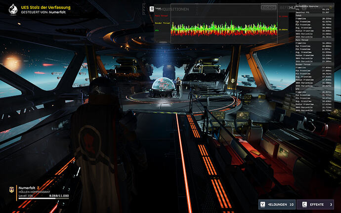

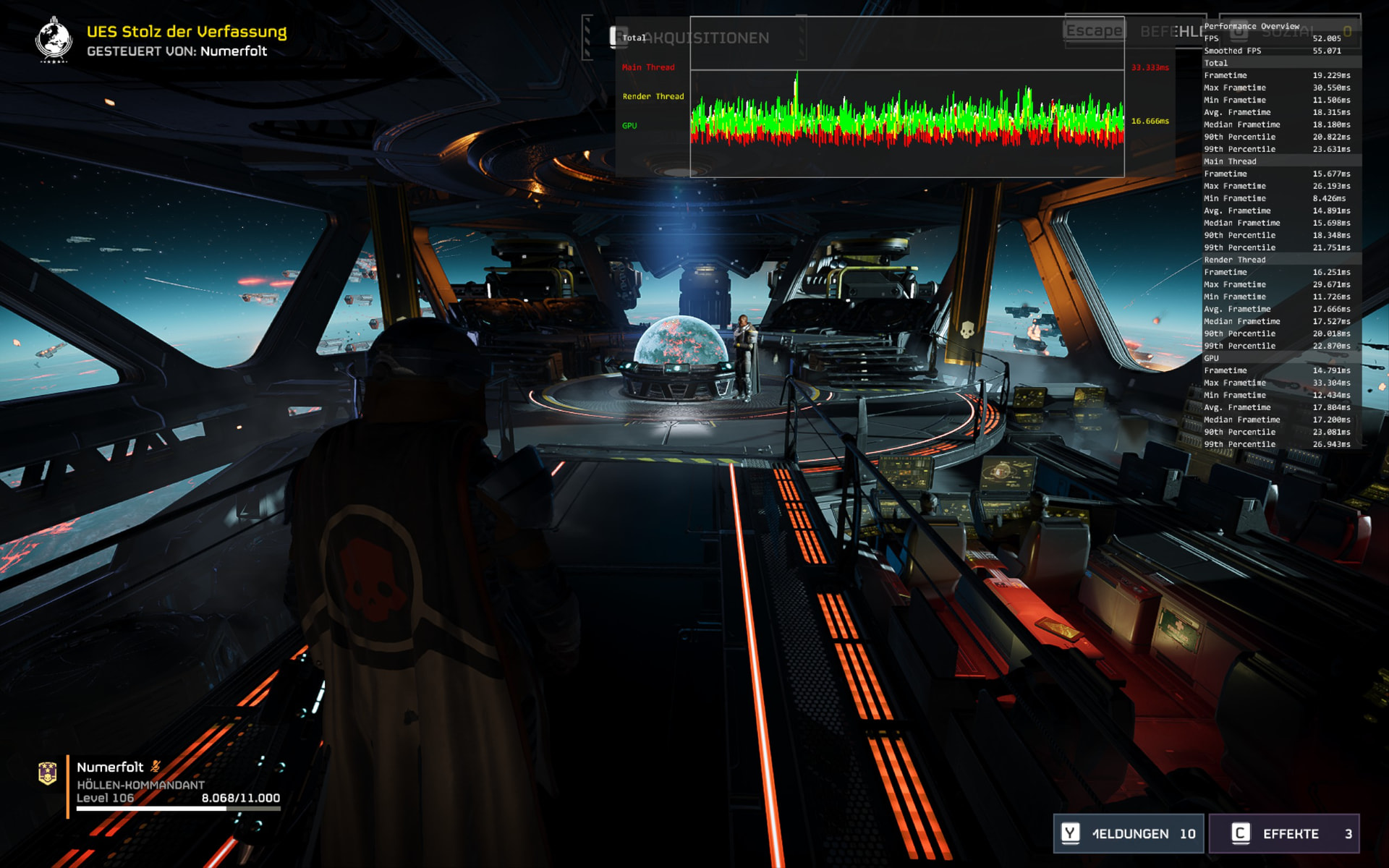

Yes, here are the results, the internal display performs worse even when set to the same resolution as the external monitor:
External Monitor 1920x1200, Game 1920x1200:
Internal Display 1920x1200, Game: 1920x1200:
Internal Display 2560x1600, Game: 2560x1600:
Internal Display 2560x1600, Game: 1920x1200:
These results are… confusing. Particularly the last two. I’m going to try and see if I can recreate your results on my setup sometime this weekend.

The erratic frame timings are indeed tied to the internal display resolution. 1920x1200 is way smoother, 2560x1600 is way jumpier…

Okay, this makes more sense (pay attention to 90th percentile):
Internal Display 2560x1600, Game 1920x1200, 90th percentile 20.822ms:
Internal display 2560x1600, Game 2560x1600, 90th percentile 22.989ms:
