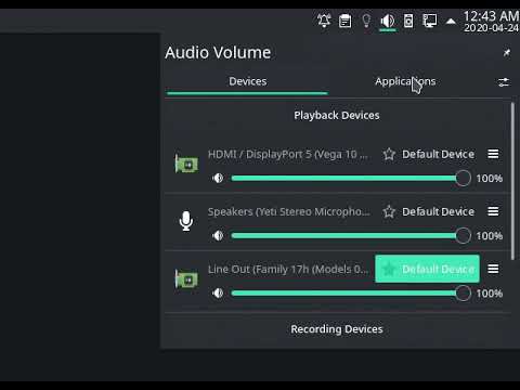

I had a similar issue myself on Fedora, and I had to change the default audio device to the headphones to get it to work.
I don’t use KDE myself, but afaik there should be a way to set the default audio device in the audio widget in the system tray.
If you set the default device to your headphones (or if your using the audio expansion card, set that as the default), then you should have it change to your headphones when you plug them in.
Here’s an example picture I found (please correct me if this is not possible like this)
