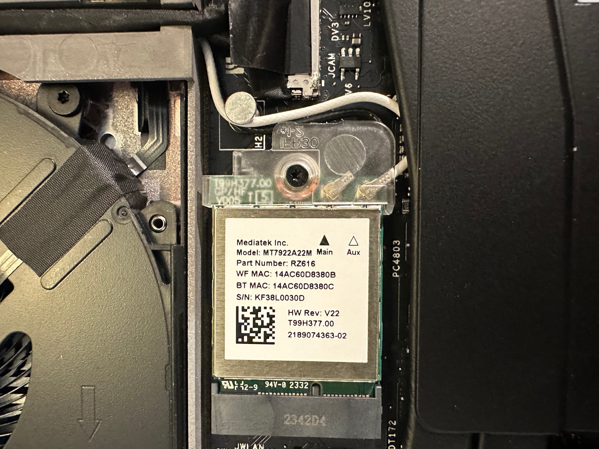

Now I can’t reattach the antenna wires to the WiFi module.

Reattaching wifi antennas can be pretty tricky. Here are some video guides that might help:
If DIY is giving you issue that’s fair enough but I do hope you will give it a shot later once initial bugs have been hashed out.
I am batch 13 so I have a long while to go.
Framework have added a weird plastic shield piece that makes it 10x harder to keep them connected while you’re slotting it in. It’s horrible.
Right now I never want to see the inside of a laptop again for the rest of my life.
Hmm… Are you tying to connect the antenna and then put the wifi card in the slot, or do you put the card in the slot and then install the antenna? I would try the second option as it is less movement once the antenna are connected.
Is the plastic shield removable? Not an ideal option but if you can get them on securely enough without the shield I don’t think they would shake loose.
I’ve found that using a pair of tweezers to position the antenna can be helpful on other laptops when reattaching antenna on an installed wifi card.

This is a brand new laptop and a brand new little plastic shield on the WiFi module. There are no videos. There SHOULD be one on Framework’s website but there isn’t.

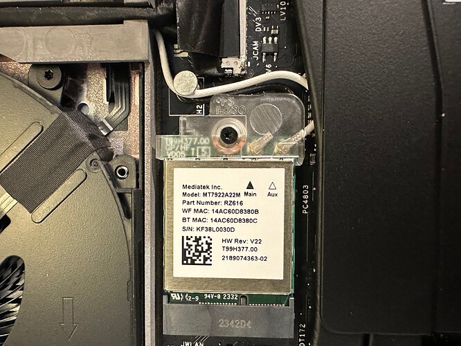

OK, this is the WiFi module. The plastic shield, which has the black screw in it, has to slide over the end of the module and then you have to insert the module into the slot and screw it down. After a dozen tries, I am unable even to put the plastic shield over the terminals without knocking one or both of them loose, let alone then manoeuvre that whole assembly into position. It is not a good design.
People have struggled with wifi antenna for ages, this isn’t framework specific.
But like the other poster said, if the shield bothers you, don’t use the shield. It’s suppose to make the install easier by holding the antenna down. If you’re finding that too physically frustrating, just don’t use it.
There should, but there are plenty of sites that show how to do it. In this case it is the reverse. The SMA connectors are always annoying, but you should be able to snap it in. Just don’t force it in. I assume that the cover also has the screw to hold the wifi adapter in. Hold down the adapter without disturbing the connection, then with your free hand place the plastic cover on top and screw it in. It is easier if you have a magnetic screw driver but if not you just need to place the screw somewhat inside the hole before threading the screwdriver onto the screw, carefully tilt it off, start with unscrewing so the threads don’t get crossed, and screw it in.

The screw is integrated into the shield. You can’t screw it down without it.
