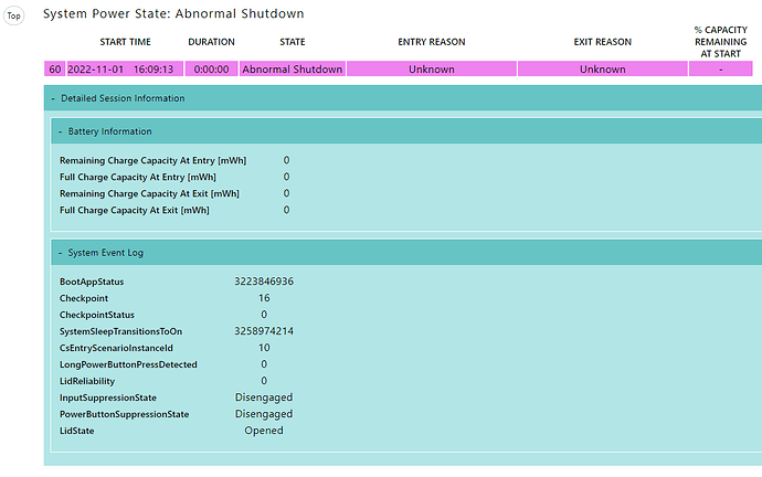

Same here. Maybe windows gets info that battery is 0? This is what I am gettin gevery time of abnormal shutdown:
Windows doesn’t shut down, it loses power abruptly (which is why it has no info in the power log). This also happens on AC power.
