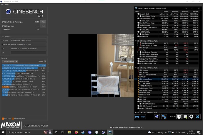

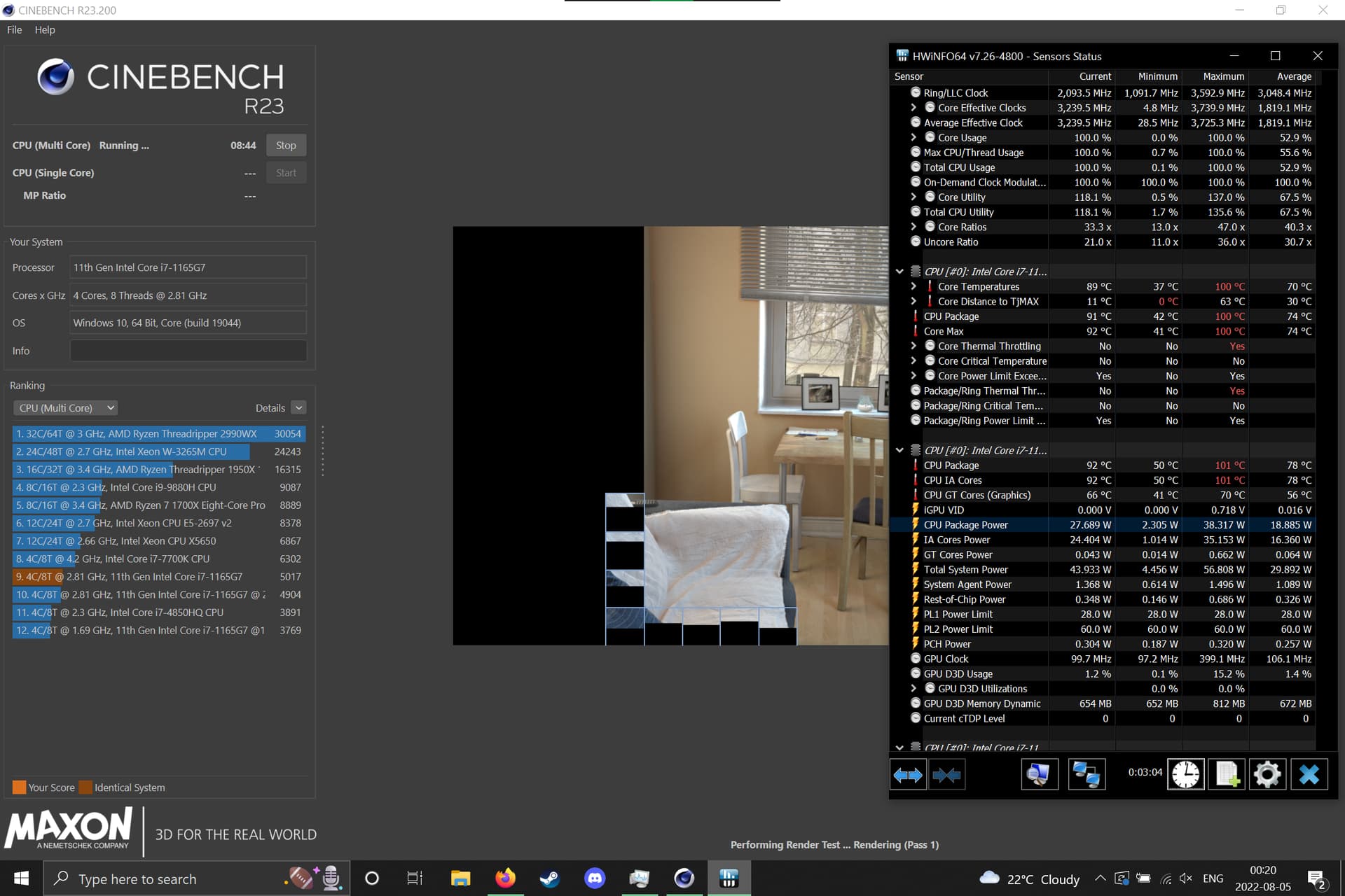

in this image, it’s throttling well under 28W. or, it was like two second earlier. I wasn’t looking at hwinfo constantly, but i’m relatively confident it never went above 28. I was holding the laptop off the desk while taking this.
You are correct. Base on the screenshot, the maximum column says 100c was reached even when the CPU was running just at 19W.

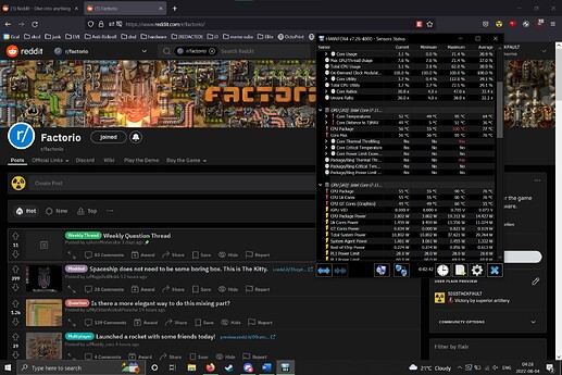

well, i’ve failed on the first test. closed every background task I could think of. I let it sit for ~5 minutes.
I hit the “reset min/max/average” button about 10 seconds before taking this screenshot. I’m not sure what the temp is but if the laptop was idling 12 degrees above ambient it would be 38 degrees and it’s definitely not that hot. Ambient is 25 at most.
as you can see above, it’s idling at ~50C.

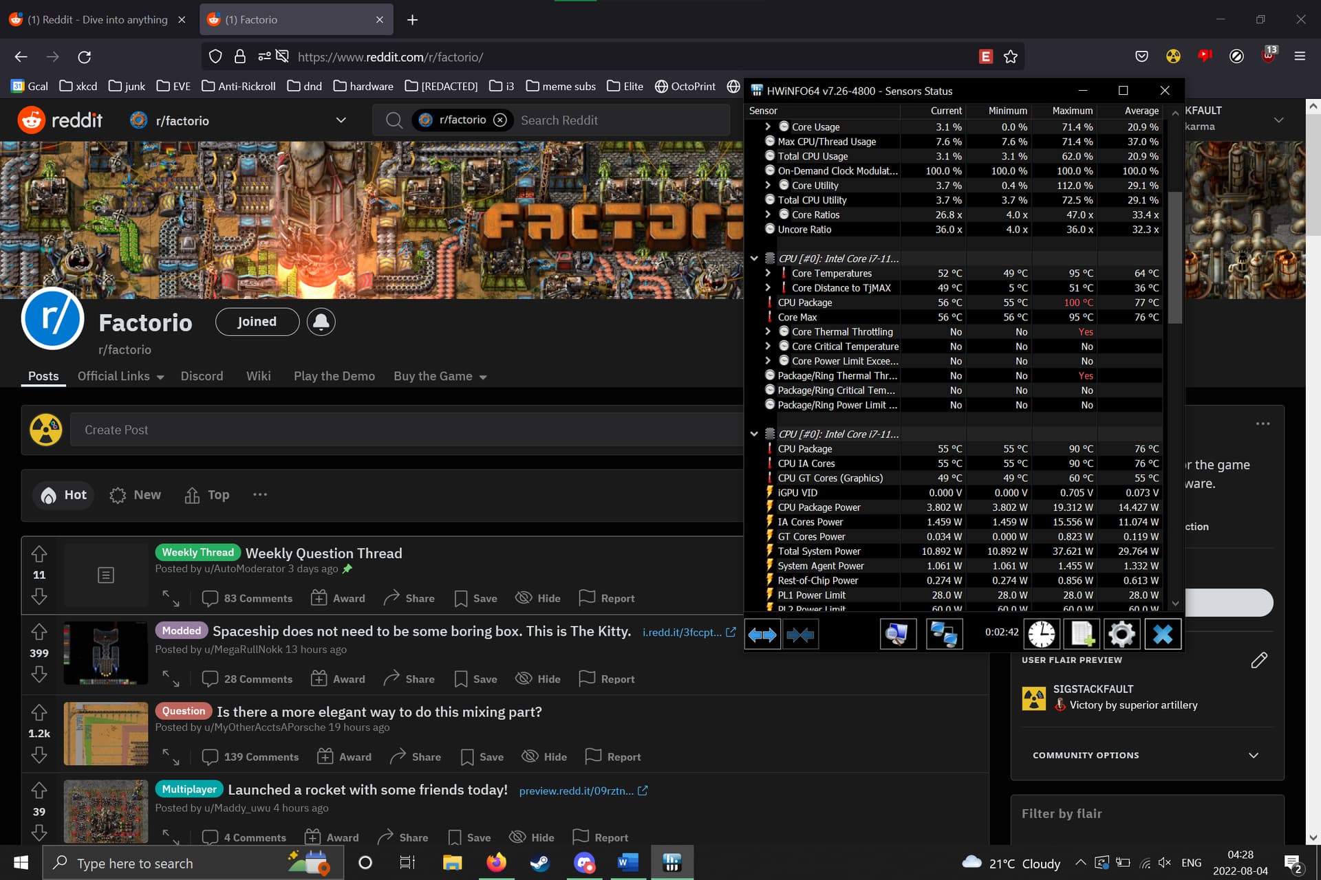

It’s not cooling back down and i don’t know what Tau is, but i have now waited two minutes. still idling at 50C.
[edit: forgot to insert this quote]
here it is after ~2 minutes. CPU package power is only 27W. it jumped to 95C after like two seconds.
