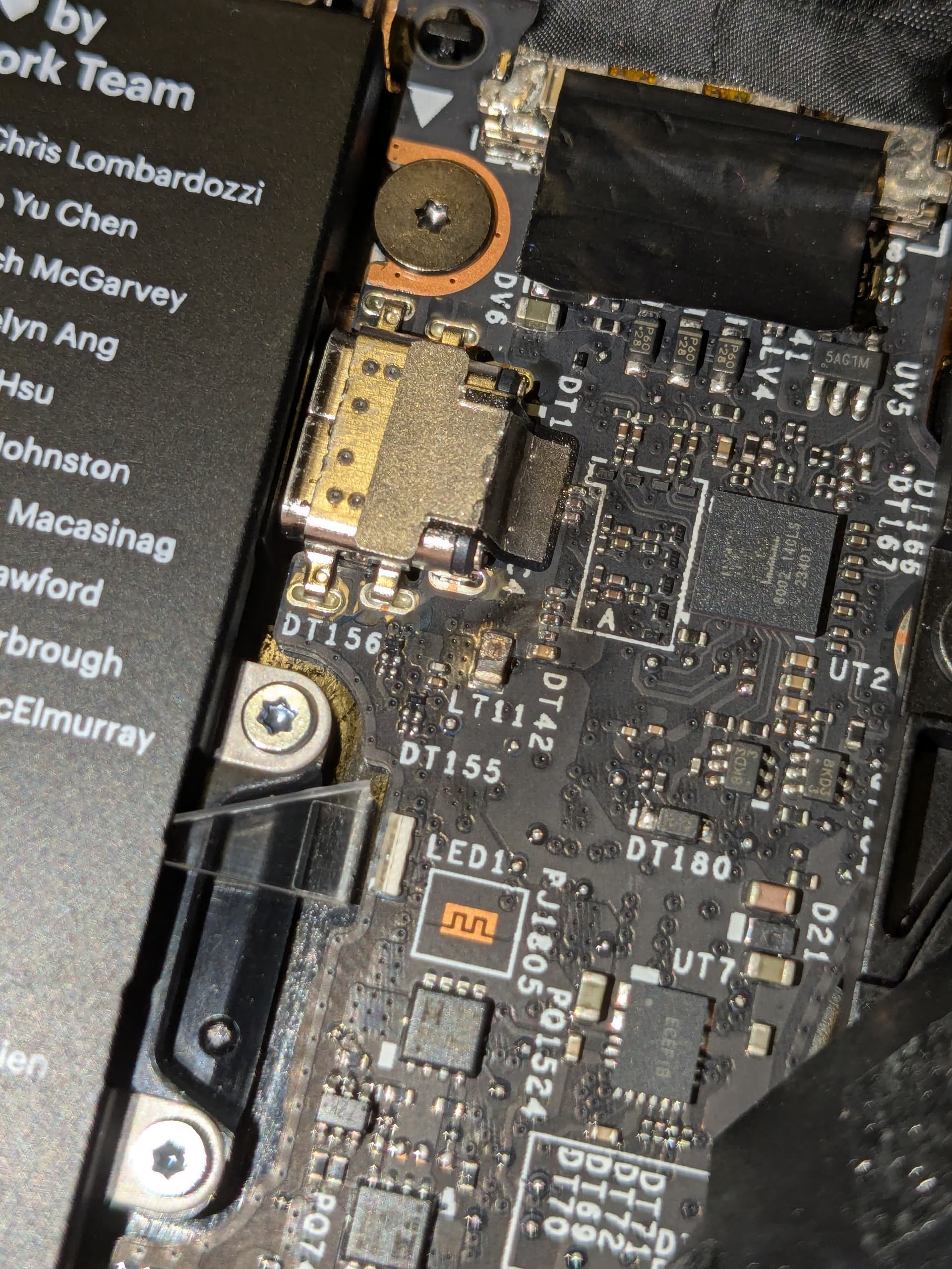

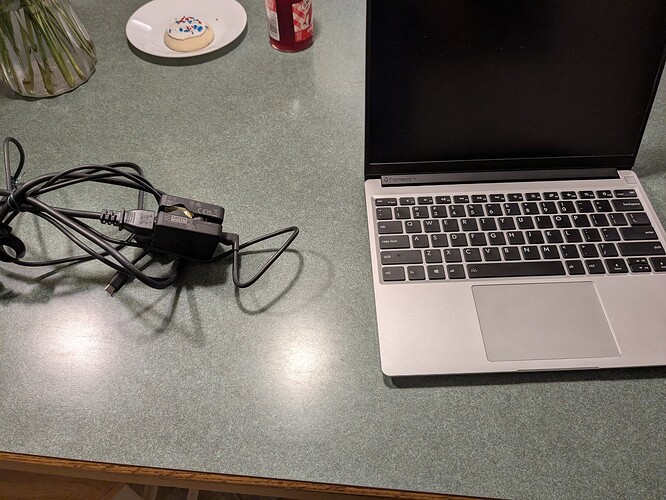

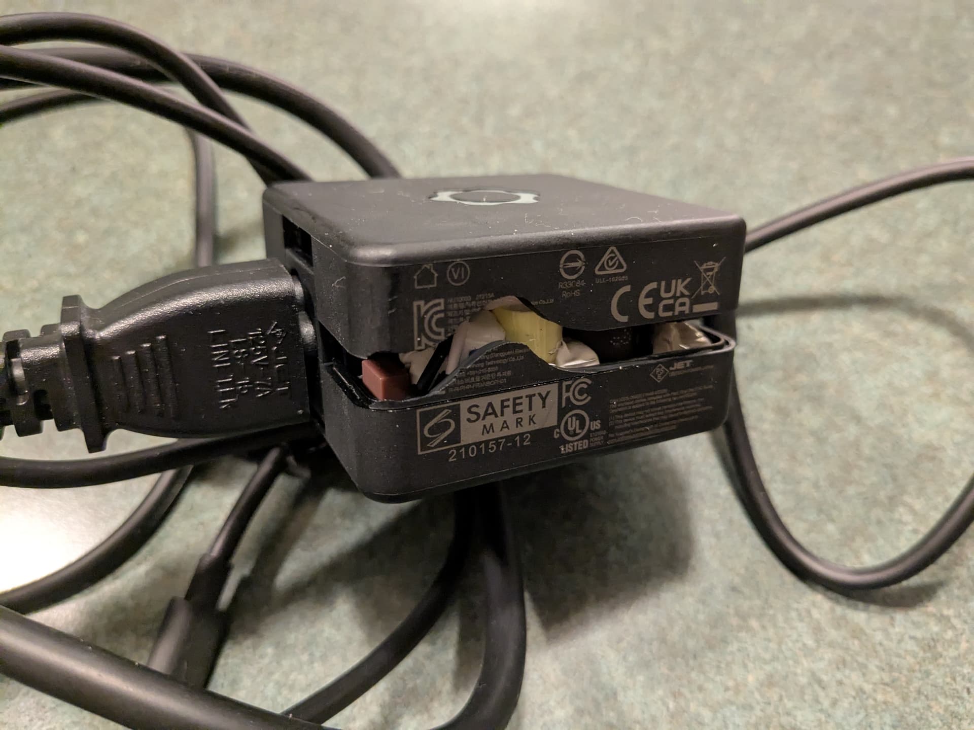

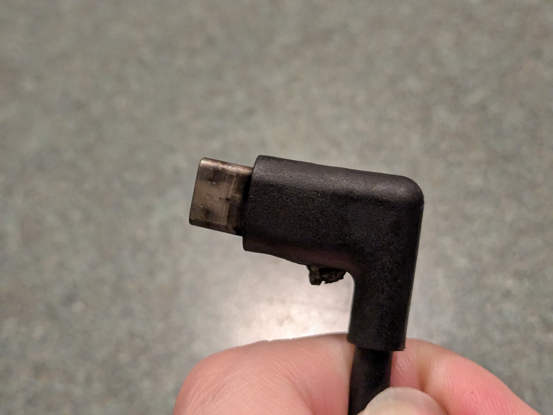

Sadly this Friday we had a lightning strike right next to our house, which fried a quarter of the electronics (including my Framework 13 and charger), blew half the lightbulbs, and damaged the breaker. I thought people here would be interested in seeing the aftermath. The charging brick cracked and blew open, and the charger-end USB cable is blackened with a random piece of metal sticking out. The laptop itself is not visibly damaged from the outside, but several surface mount components on the mainboard near the rear left expansion card (the one I was using for charging) are damaged, with one larger one (LT11) being split in half. Unfortunately, the laptop no longer turns on.
Regrettably, it wasn’t plugged into a surge protector, but I honestly doubt it would have made a difference, as a modem, Eero, and old desktop computer in the house were fried right through the new surge protectors they were plugged into. I guess that’s what happens when lightning hits your building’s electric grid! I’m just glad the house didn’t burn down.
I hope I can repair my Framework, but I’m not sure if most of the components are damaged, or only the mainboard. The SSD works at least, and the rest of the laptop appears undamaged, but I have no way of testing any of the other components. What do you think? Should I order a replacement mainboard and see if it works?
Might as well take the chance. Worse case scenario, the mainboard will not work with any components that are not functional. I’d recommend replacing the battery as well, just to be safe, though I imagine that most things that could have gone wrong with the battery would have already, but you never know with lightning.

That is some serious damage. Lightning is no joke with as far reaching as it can come into anything that will conduct it. Your Mainboard is done for sure. Even the best surge protectors in the world might have mitigated some of it but not all.
The battery should be in good shape as that much current and voltage fried the mainboard probably before it hit the battery. Fortunately the little regulators just pop or burn out in todays electronics because they are so tiny to begin with along with the small traces on the mainboard.

Thanks for the pictures. Keep us updated with what you find out survived. :zap:
