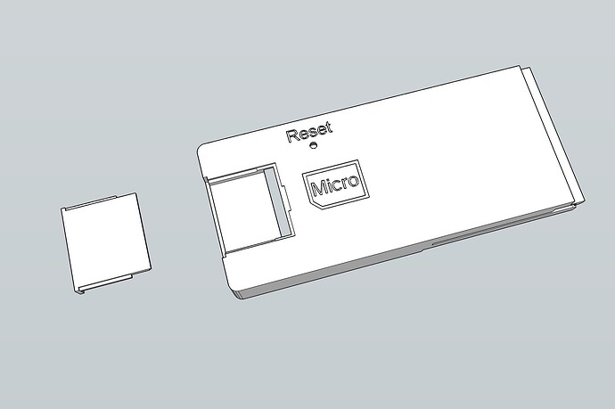

Good evening all. I’m Jacob Eva, representing my company Liberated Embedded Systems Ltd.
We have been working on an LTE expansion card for quite some time now, and we’re excited to show some early renders of our module for your reference!
Top view.
Rear view.
This module will support 4G LTE speeds (no 5G, too expensive!) and has three connectors for antennas. The two larger connectors are SMA connectors, with the antenna on the left being the primary antenna, and the one on the right an optional diversity antenna. We also have a U.FL connector to allow for the connection of a GPS antenna (yes it works!) to the laptop. We have additionally included a nano SIM card holder on the bottom of the module to facilitate inserting a SIM card, so you can actually connect :wink:
Might I also add, this will be open source hardware (design files will be released after completion), so no anti-consumer withholding schematics shenanigans :wink:
We expect to be performing some test trading of this module once we have put it to production, which should be within the next couple of months.
Therefore, for any of you who may be interested in purchasing our module, please email us at contact@liberatedsystems.co.uk to sign up for our newsletter (please also include your country of residence too so we know where our market will be!) so that we may notify you when it will be available to purchase :slight_smile:
That’s all for now, technology for freedom.

Interesting! But… If it’s a 4G module… How to insert the SIM card?
Apologies, I forgot to mention this! There is a nano push-push SIM card holder on the bottom of the PCB (there will be a small hole in the side of the final module), into which you can insert a nano SIM card :slight_smile:
Similar to the initial proposal in the 1st post of this thread/topic?
Yes, that’s right.
That module is going to be extremely long when assembled, I hope you are going to reinforce it as that will very easily break (3D printed) What module are you using as there are only two that I know of that fit, which have country specific modules?

It will exceed the dimensions of the expansion bay, yes, but only by a couple centimeters at most. This is required due to the SMA connectors.
This is an early design, much can still change after reflection :slight_smile:
I won’t discuss this for now I’m afraid. However, once we begin selling, the design will be open-sourced.
I’m asking to know what bands it can support which is a perfectly reasonable question.
Apologies. In that case, we will have options which will support different regions. Since we are based in the UK, our first prototypes will support those European bands (which should mean it will work within the EU), with future versions supporting other economic areas too.
Regardless, if you are an American or from other continents, please still get in touch with us so we can gauge interest. :slight_smile:
