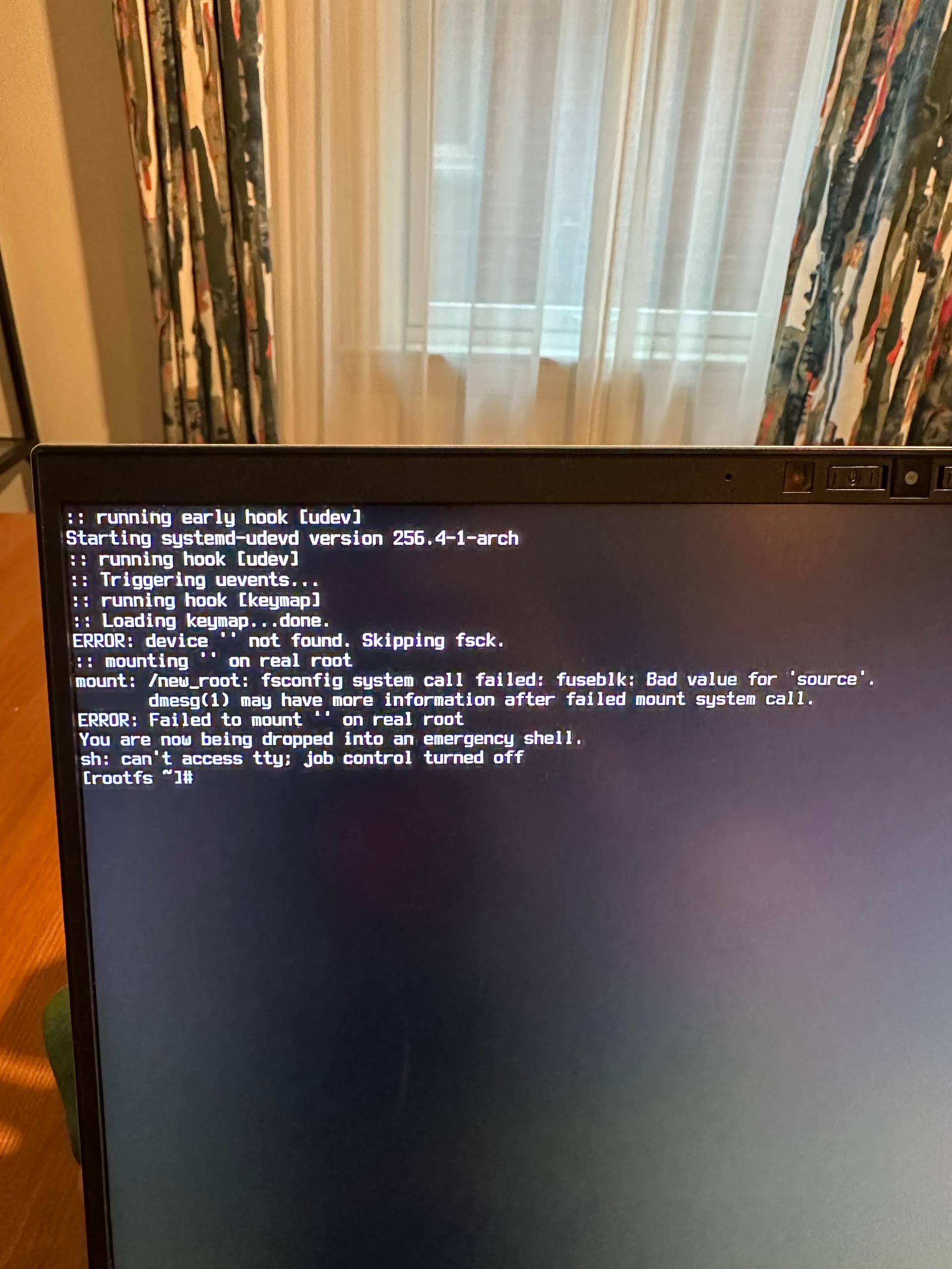

My first 4 attempts went well until I had to go and boot the system, everything worked without any errors until I rebooted to the rEFInd boot manager and selected arch as my OS, It tried to boot and failed giving me an “emergency shell” that I had no idea what to do with. I followed the install guide for the next 3 attempts getting the same exact error each time. It is worth noting that I had the install guide open on my phone not another computer. This caused some of the commands to be formatted incorrectly so instead of entering
ln -sf /usr/share/zoneinfo/Region/City /etc/localtime
I was entering
ln -sf /usr/share/zoneinfo/Region/City/etc/localtime
I am fairly certain that this is why It was unable to boot however I do figure out something else on my 6th attempt that might disprove this.

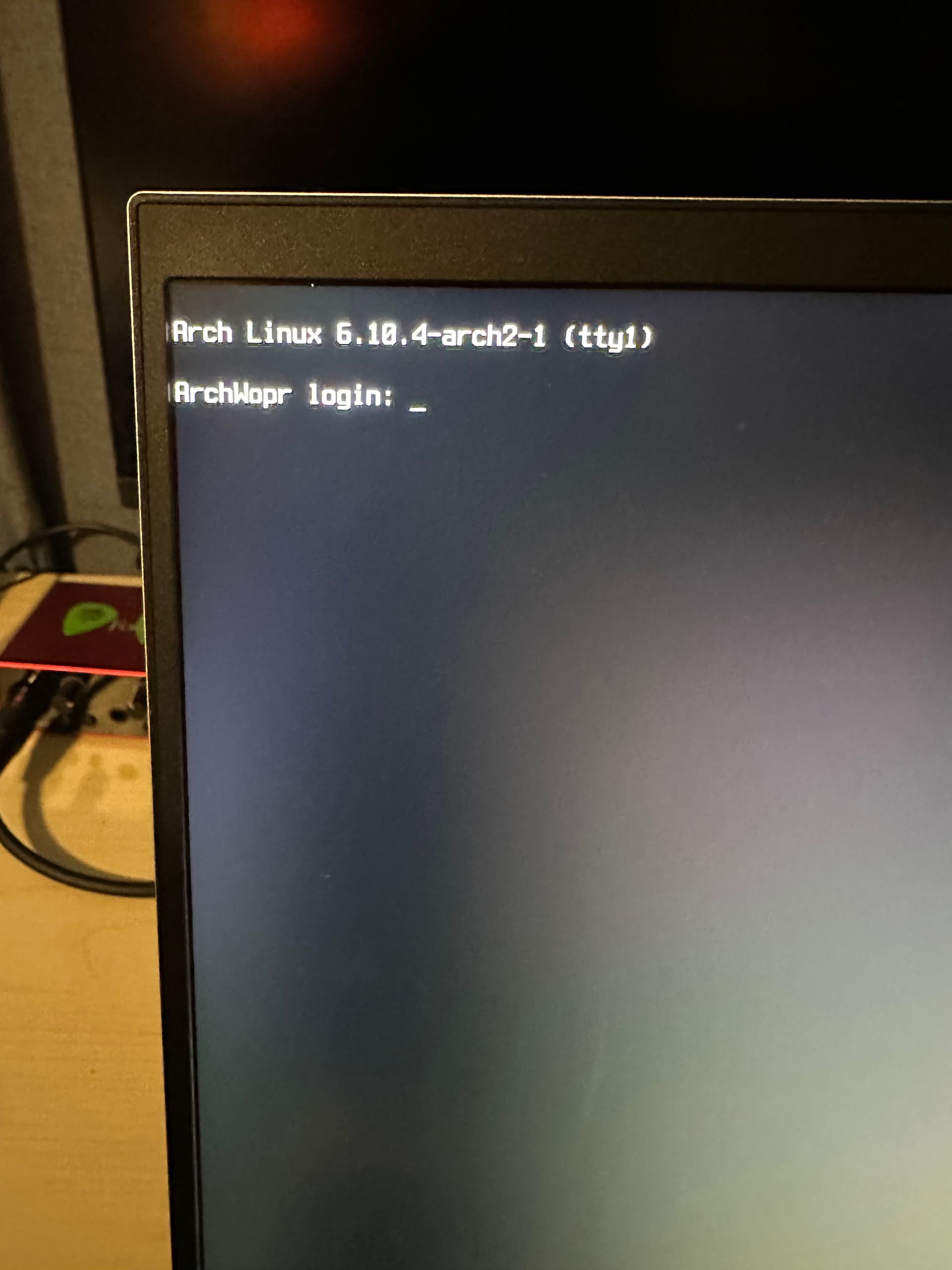

My 6th attempt was the first time I successfully installed and booted arch Linux after about 3 hours and 30 minutes, I followed this video and was able to get everything to boot using grub (I did not set up dual booting through grub) additionally I installed Hyprland in place of KDE plasma, enabled sddm and attempted to sign in to the account I had created, Upon signing in I did not the the screen I was expecting, instead I saw a waring that I was using an auto generated config file.
After getting the OS to boot through grub I went back and tried to use rEFInd to boot the system and I got the same error that I got on attempts 1-4 which likely means that my previous attempts failed due to a misconfiguration or rEFIned

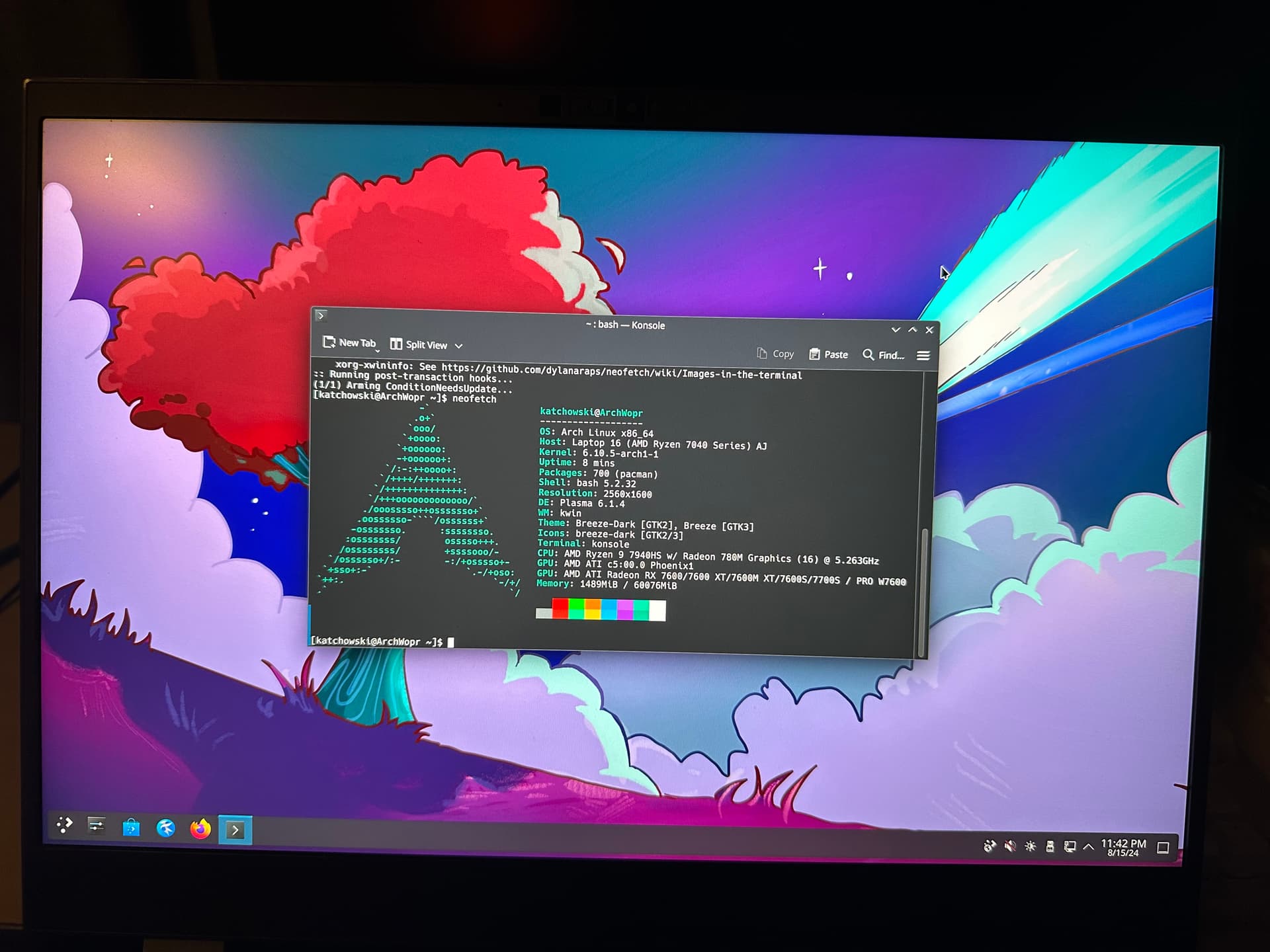

Attempt 8 was a success and I am now writing this from Arch Linux on my framework 16 laptop. There were a few hiccups when I messed up my grub configuration and managed to make my bios so slow that I was counting seconds per frame but a quick reformatting of my partitions fixed that.
