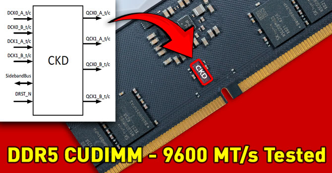

Apparently, the 358H with the 12 Xe B390 GPU can support SoDIMMs going all the way to DDR5-7200:
https://www.asrockind.com/en-gb/NUC-358H
Yes, PantherLake supports CUDIMM. JEDEC basically added additional clock to help with stability on higher speeds.
Intel shipped reference PantherLake boards with 6400MT/s SO-DIMMs and getting memory stable is part of the reason why PantherLake was delayed.
