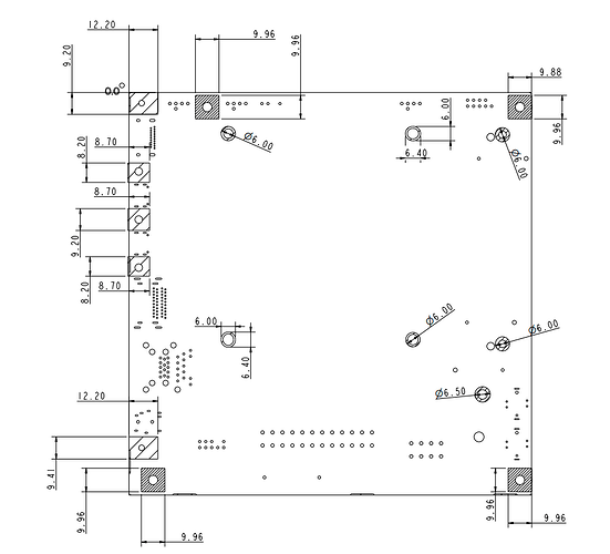

I’d love to figure out the width of that orange square in the bottom left corner of the motherboard. If we knew that, we’d be able to figure out the space between the pcie slot and the bottom edge of the motherboard, which is where the power supply would be.
9.96mm according to this pdf: Framework-Desktop/Mainboard/FRAMEWORK_DESKTOP_MAIN_PCB_V0.pdf at main · FrameworkComputer/Framework-Desktop · GitHub

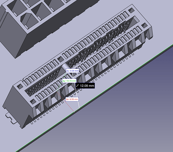

There is also a step model of the mainboard with the PCIe port. It should be 6.55 mm from the pcie card surface to the bottom of the mainboard if I got it right.

I also found these:
The first image suggests the board is 173mm x 173mm. The second image shows that the top left corner of the pcie slot is about 162mm from the top… or 11mm between the top edge of the slot to the bottom edge of the motherboard. I guess the next question is how much space is between the bottom edge of the motherboard and the power supply, haha. Moral of the story: Not a lot of space… but I still wanna find out how much, haha.
