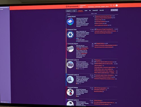

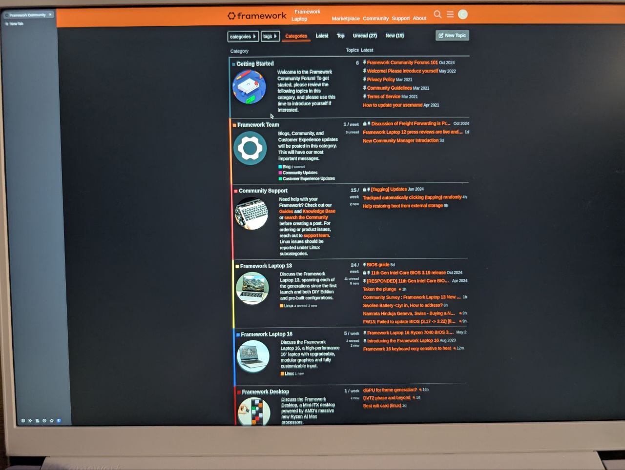

Hey all, just got my Samsung OLED monitor set up. However, every thing on the screen has a green tint. I am attaching an example below. I’m not sure if its the OS, laptop or monitor. Anyone had this issue and know how to fix this?
edit:(this is how it looks at night, so bright light)
Laptop:
Monitor:

Just tested on Windows on a 12th gen FW 12, and it looks normal. It likely the OS, but I am not sure what is causing it.
You could try booting up Fedora 42 to see if you’re having the same problem there
Hmm, it is back to normal now - unplugged the monitor and closed the laptop for the night and now it is back to normal
