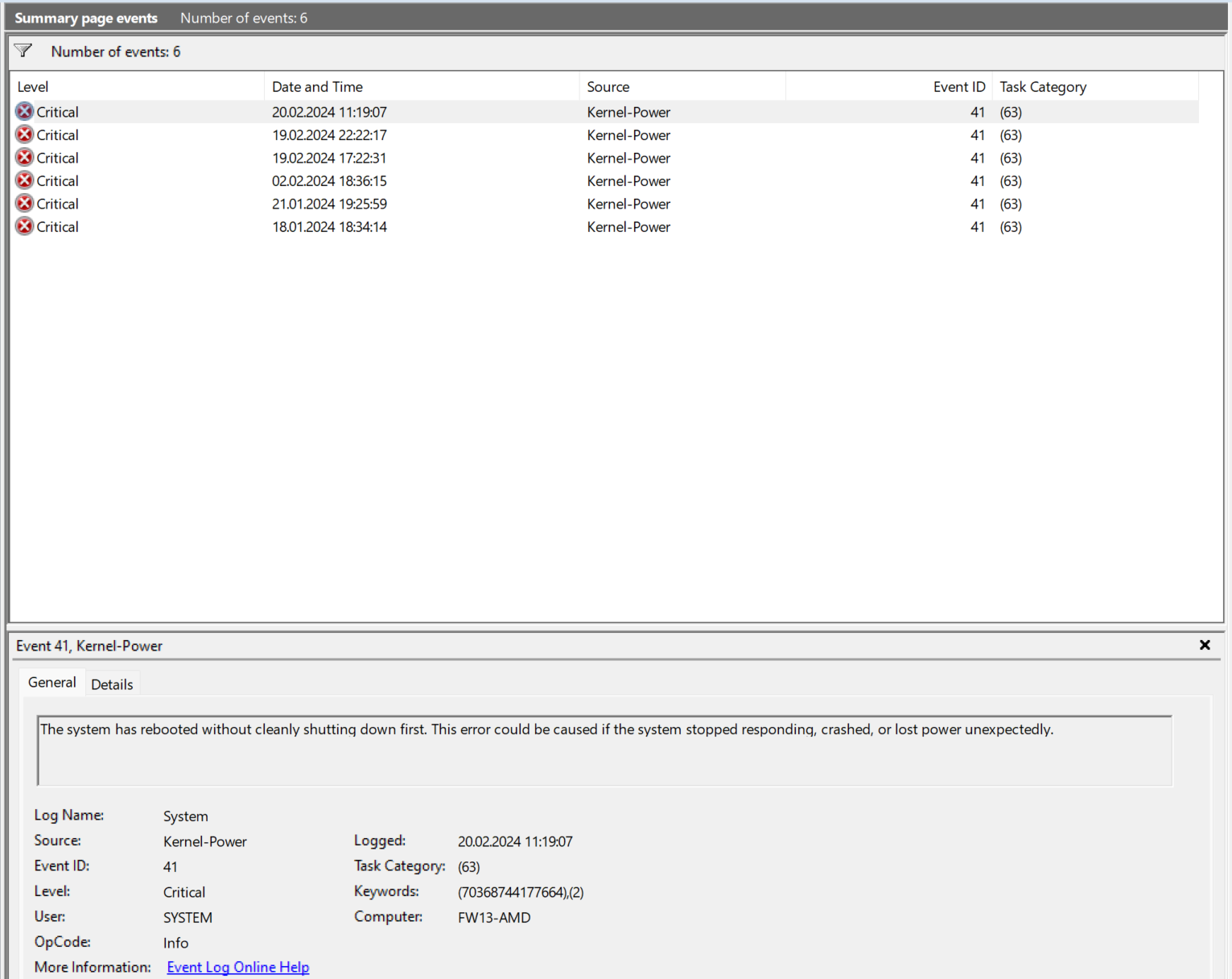

Hello,
in the span of one month I have experienced coupel of PC freezes. The PC was completely unresponsive and only way out was to hard reset with the powerbutton.
All of these unclean shutdowns / reboots were caused by this issue. Yesterday I had two, and today I already had one.
The earlier freezes resulted in BSOD. But te last three freezes I waited some tens of seconds and then lost patience and hard resetted my system with the power button.
Initially I have installed W11 from scratch and applied immediately the official FW drivers pack.
I kindly ask for assistance with this issue.
Anything in the system log immediately before those events you screenshotted? Or did you capture the blue screen error?
You might want to try a memory test, since that’s the easiest hardware issue to directly diagnose.
And it happened again just now. After I wokeup my pc from hybernation, couple of minutes of internet browsing and suddenly freeze. This time I let it sit frozen for longer and after some minutes I got the BSOD. Unfortunately I did not manage to catch the eact code.
Analyzing the events from event viewer I can see that in the same minute when the freeze happened, number of errors accured.
Rings any bell?
