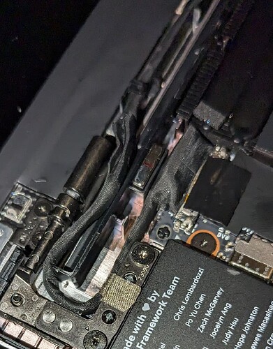

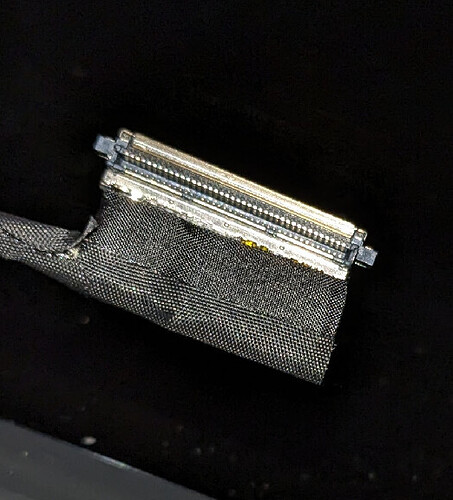

@Matt_Hartley, re-did this, and took a bunch of pictures of the quality of the connector / cable routing, too (I don’t know what to look for, so hopefully the pictures are sufficient)
RGB static still exists tho. What other debugging techniques can I try?
I’m still skeptical of the possibility of a hardware issue because of the Manjaro Linux link from above mentioning some fix in Kernel 6.6.
Appreciate the images. I agree, if it’s working on Manjaro, it’s not going to be a hardware issue. As stated here, just to clarify:

Based on the images and the lack luster logs, plus assuming that was supposed to be a solid dark/black screen, that looks like a bad screen connection or a screen itself. Please file a ticket and link to this thread.

-Take off input cover and remove screen bezel
-Disconnect display adapter on lefthand size of the board
-Reroute the display cable to ensure there is clearance around pinch points/bends
-Inspect the display connector plug and jack and make sure they are clean and debris free, blow out just in case
-Loosen and retighten all the mainboard screws
-Retighten all the screen and hinge screws (many of these had become loose)
-Reconnect display adapter, making sure to carefully align and fully seat
After that I saw no more static and everything is working as expected. Seems like it’s some sort of hardware issue related to either grounding, cable connectors, or cable strain but I was lucky it could be resolved without needing to replace the display.
