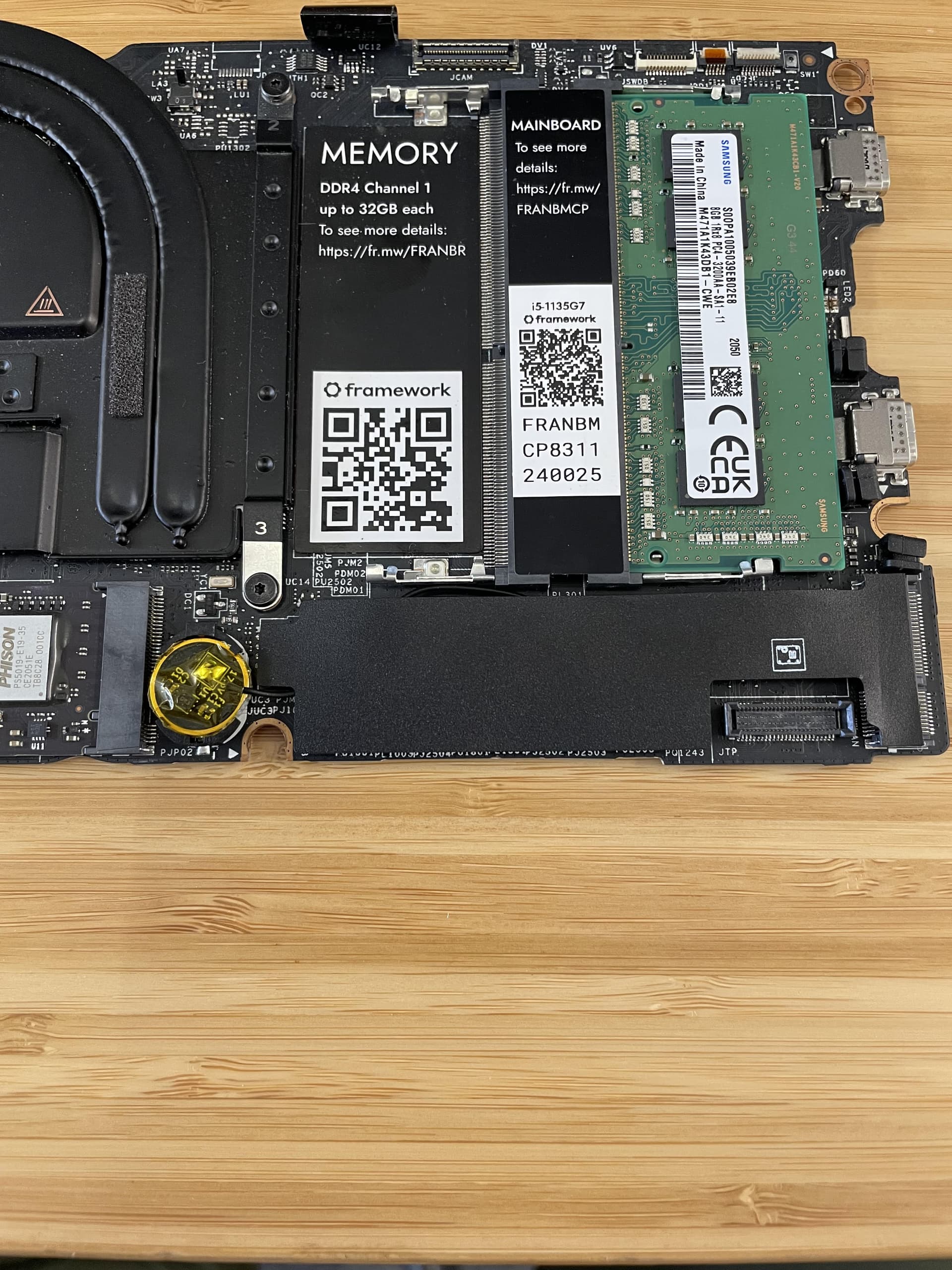

Rework Instructions for 11th Gen Mainboards to enable powering the RTC circuit from the main battery

The hopefully final revision is currently inbound as soon as DHL can figure out how to reach our office. We also handed out a few of the pre-production modules during LTX over the weekend.
That was fast. We received the latest rev today, and it fits well. We are writing up a guide for this now and also drafting the service related instructions for how to get the module.

I’m just going to say, if you need instructions/guidance on how to solder in general, this isn’t for you, while the components aren’t tiny, they are still quite small and will seem tiny to anyone new to soldering, I really don’t want to see ripped pads, and also if your laptop is still in warranty and you attempt this repair and it causes further damage, support will likely not help.
This is correct. This is relatively straightforward soldering job, with just a single wire being soldered to a single point. However, it’s a soldering job on a multi hundred dollar item, which isn’t a great project to learn how to solder on. There are a lot of great low cost kits that you can use to learn how solder with, and then once you have practice, you can try something like this. In the meantime, we would recommend bringing it to a friend or a local repair shop to do it.

The step by step guide is available here: https://guides.frame.work/Guide/RTC+Battery+Substitution+on+11th+Gen+Intel®+Core™/203
Note that this guide covers what to solder, but not how to solder. We would again recommend practicing the how of soldering on low cost project PCBs before soldering on a Mainboard.

We’ll be sending the module for free by request to folks on 11th Gen who have run into needing to perform the reset on their Mainboards and who prefer and have the ability to solder this module rather than receiving a new coin cell. It will still take us some time to get this process started, as we need to position the parts at our warehouses for fulfillment.
