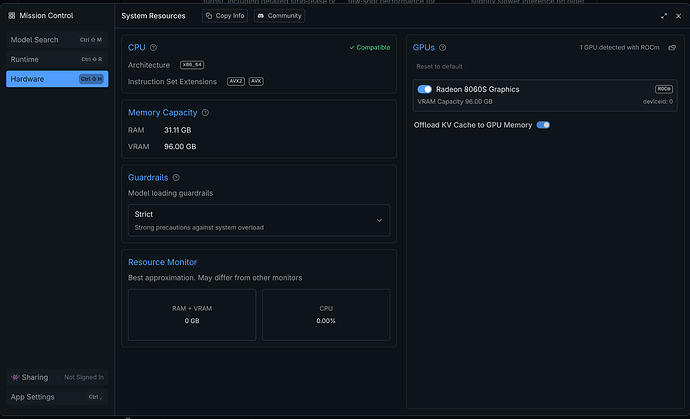

I don’t know how else to check if it’s actually using the iGPU – it looks like it is but… ??

Based on your screenshot above, your iGPU should be enabled and used, if you have a Vulkan or ROCm runtime enabled (you might want to check that as well) EDIT: ignore that, I noticed now, after @vdtdg pointed it out, that ROCm is enabled.
Also, which settings are you using, when you load the model ?
I see on the right-hand side that it’s detecting the iGPU properly and using the ROCm stack, so that part looks good.
Personally I use the Vulkan stack because it’s simpler to install and tends to be more stable, but ROCm usually delivers better performance.
There might still be a few technical points to verify, like whether every model layer is actually running on the GPU.
