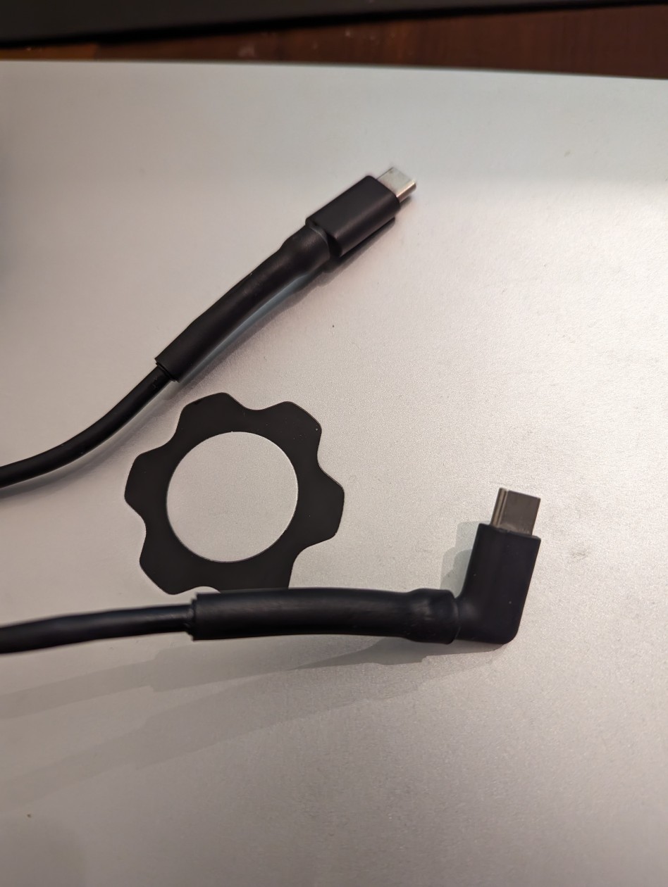

I fixed this problem on my cable using some heat shrink tubing (bought on amazon) to cover the split ends. In particular, I used 5/8" diameter tubing to get over the straight end usb connector. Slide the piece of tubing (cut to an appropriate length) over the straight-end connector, then down the length of the cable when fixing the right-angle end. The tubing I used had a 4:1 shrink ratio, but 3:1 might(?) work too.
